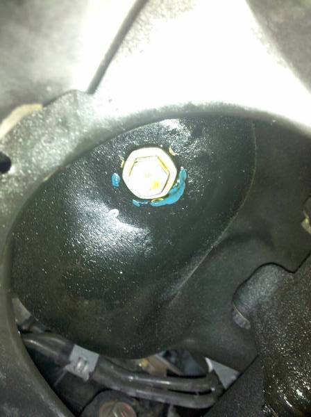

    Here's the pic:

    Thats definetly your oil drain plug for the engine, not to be confused with the one further back for the trans....

    its real hard to tell from the pic there...if had a pic zoomed out more would help but it belive it is the oil drain bolt

    you prob. just need a new crush washer
    or snug it up a lil

    Yeah I'd say its the washer...but also make sure its tight too. Doesnt need to be crazy tight, but good and snug.
