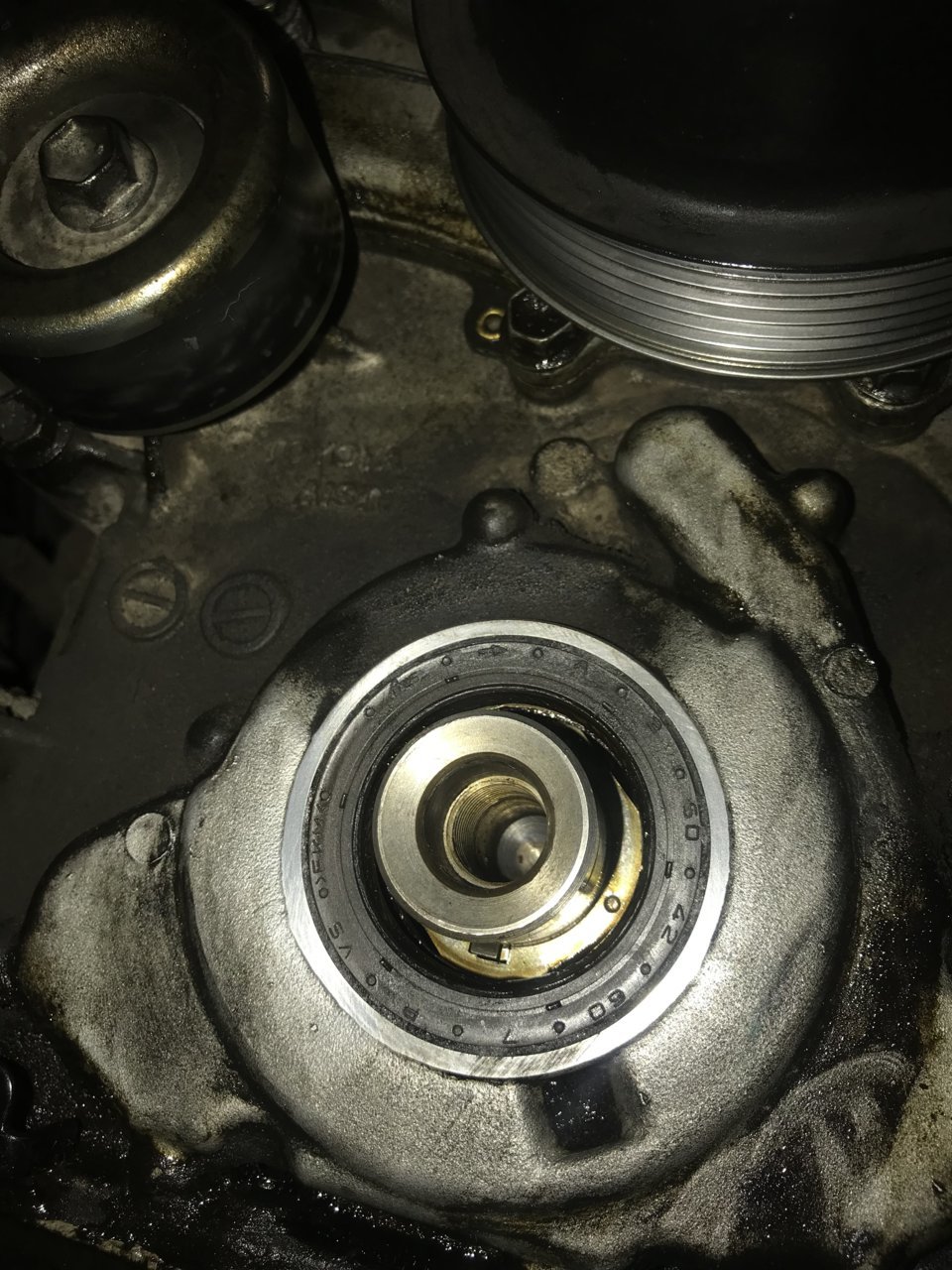

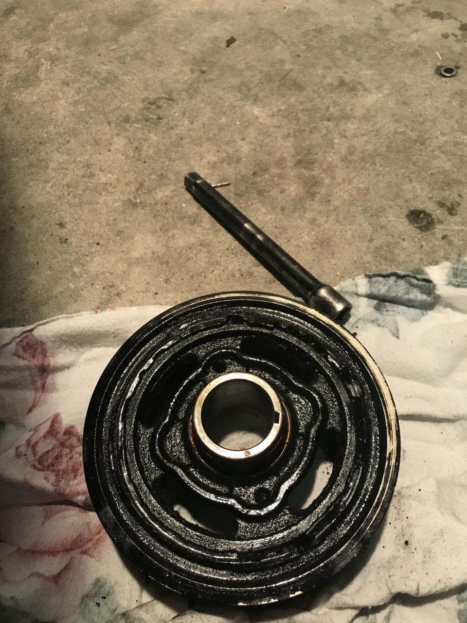

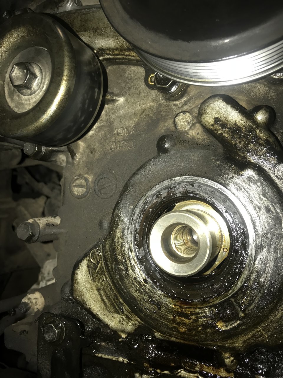

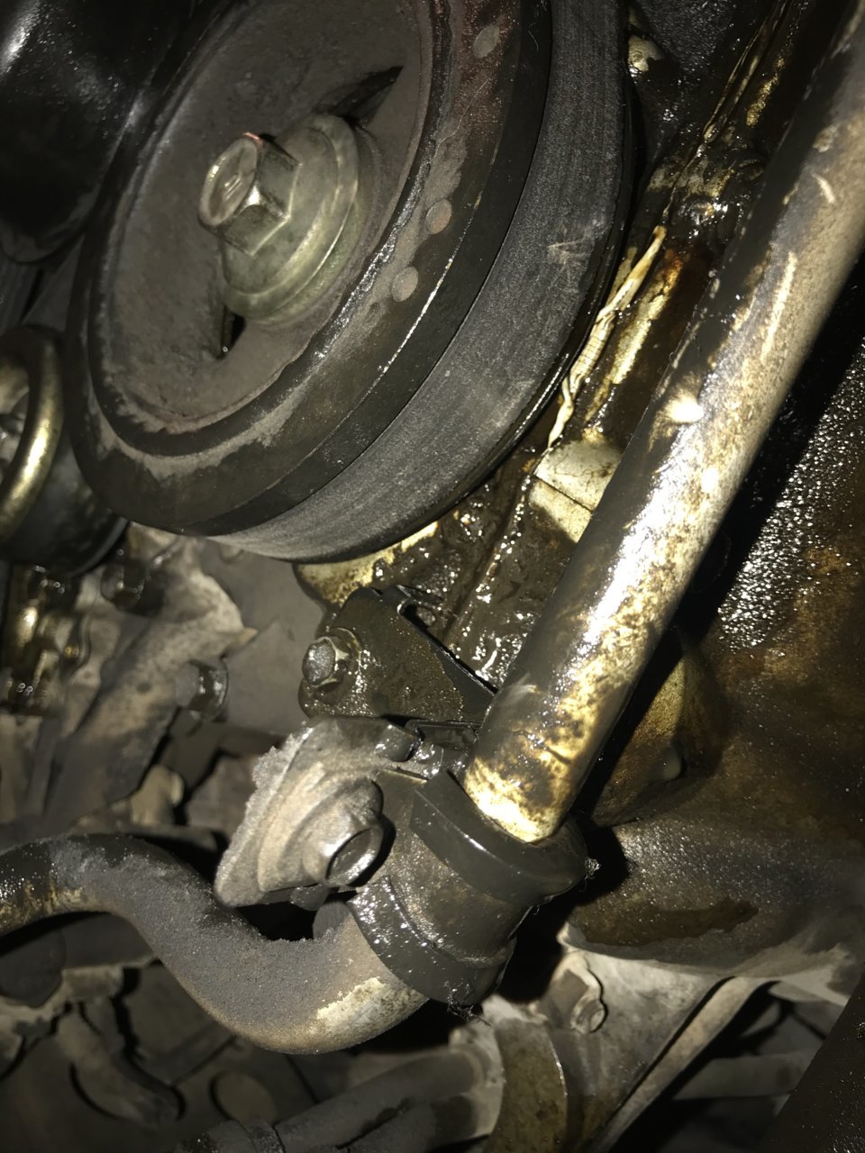

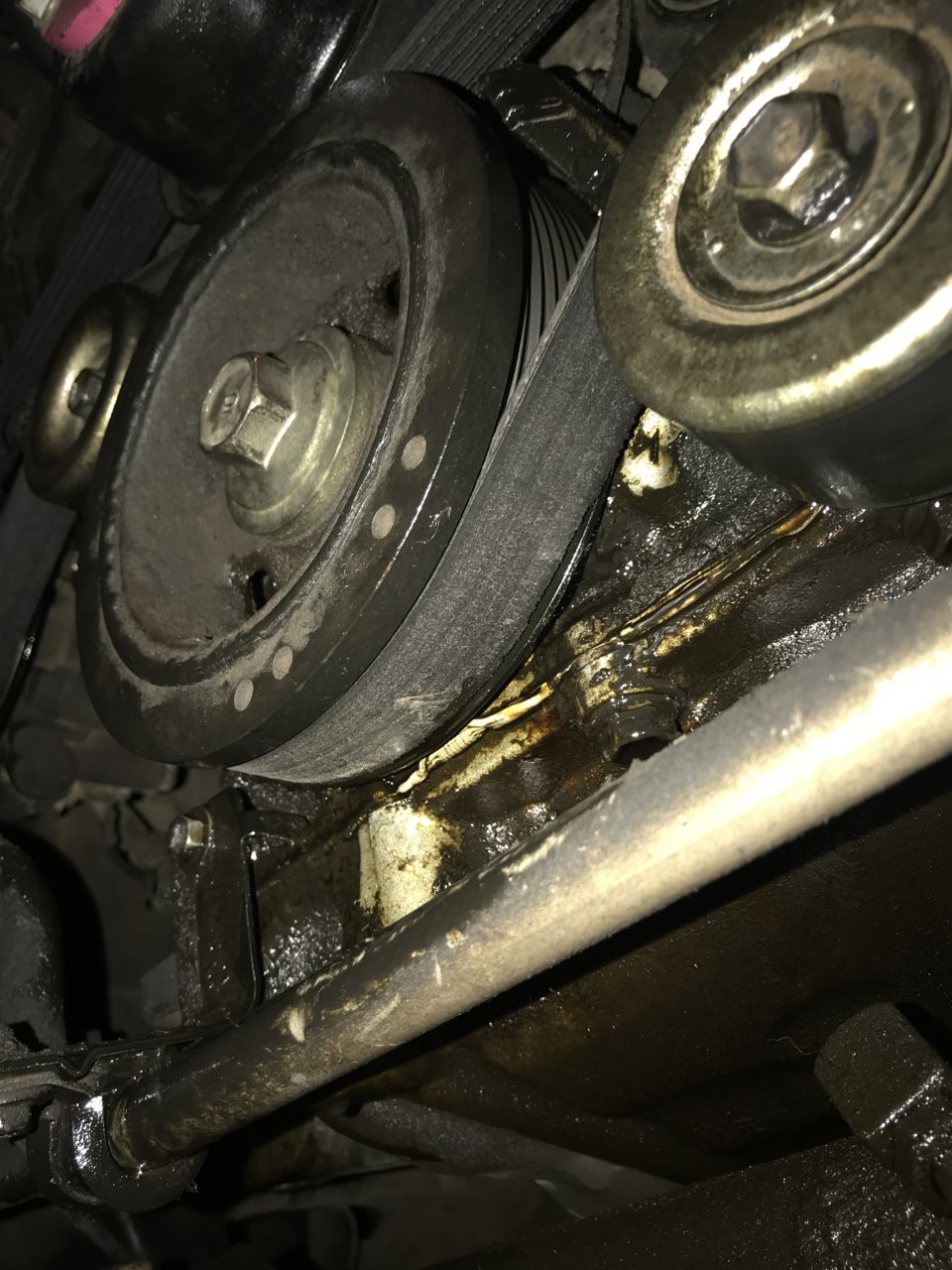

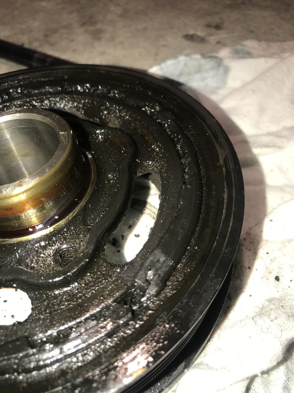

    Here’s better pics
    1AFF2E02-661C-4D1D-BB3A-A3D8AF2A4746.jpg 46AE3191-D4B7-4E15-B1DA-A0EF08582A6C.jpg
    Radarninja likes this.
  8. Jul 15, 2018 at 3:31 PM
    #48
    anthony250f
    anthony250f [OP] Well-Known Member
    Feb 18, 2012
    #73066
    16,760
    Anthony
    San Diego, CA
    2008 dcsb trd offroad 4wd
    Well it’s definitely leaking from this seal. E09E9FC2-1C5B-4310-BDFD-17E5B1821CBB.jpg15777286-DEE1-473E-AB36-0697D9457584.jpg09D071FD-9DF0-4AB0-9F03-EEDABFD4A382.jpg

    i used simple green and a pressure washer and blasted it all off, best the motor ever looked. Glad we figured out it was indeed the crank seal though!

    Including a new damper / pulley assembly, correct? That one be toast, man!
    Glad to see it will be a pretty easy repair, all things considered.

    Parts I ordered are
    -new crank pulley
    -new seal
    -new belt
    -new bolt
    -crank pulley holder tool
