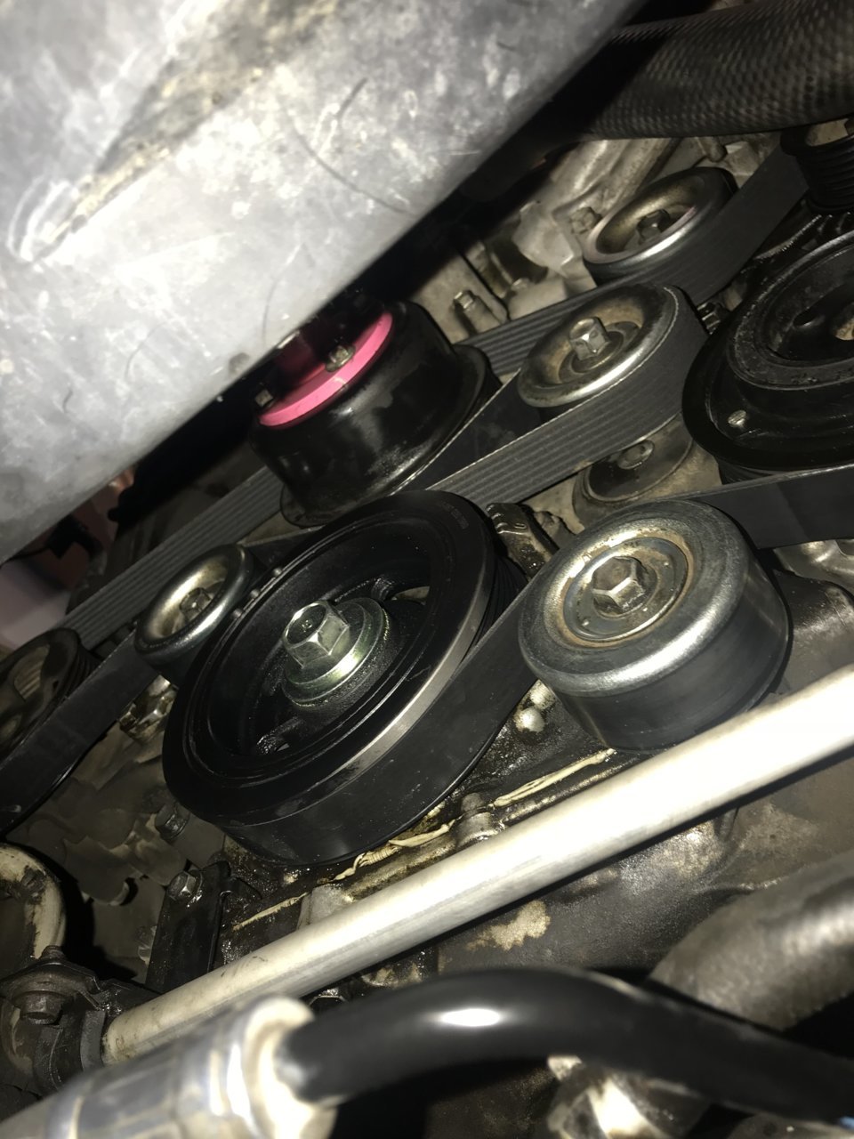

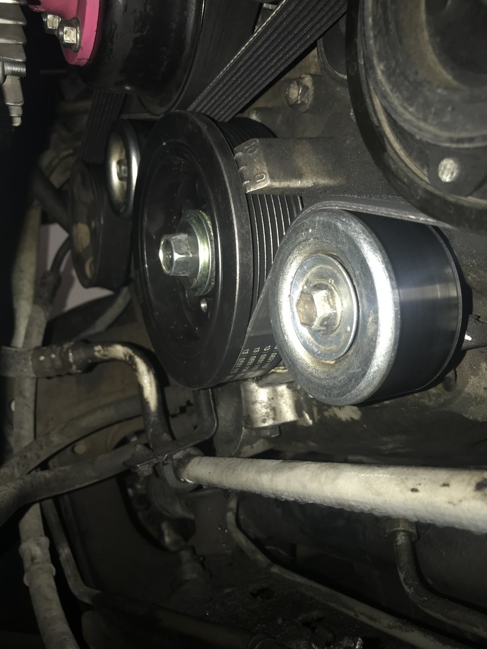

    Everything is fixed.
    Only concern now is it looks like the pulley may have a very slight wobble :oops: may just be my eyes but it looks like it. No leaks.

    Is it an OEM pulley?

    Remember there are tolerances for everything! The wobble may be in spec, mine looked the tiniest but wobbly but it hasnt casued me an issue in the last 35 k

    I drove the truck Last night and checked it out. Zero issues and the oil does not leak anymore. Success.
    Now if only I could find this onnoying pulley rattle lol

    Wouldnt be worried about it, its very minor almost not noticeable!

    I did and the noise is exactly the same lol
    Also because I’m OCD I ordered a new crank pulley and will be doing the pulley swap again soon lol

    Re did the job and used the powerbond pulley and now it’s as straight as an arrow. Much tighter fit as well.
