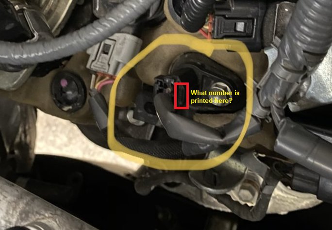

    Long story short. Changing my plugs.. slipped on stool and my hand was under that sensors wire. I unseated one of the wires on the sensor circled in yellow. Truck miss fires randomly when starting.. looked around for schematics but couldn’t find anything. Anyone know what sensor that is? Thanks for helping my dumbass

    Looks like right hand camshaft position sensor

    Take it out. Part # should be there.
    By the look it resembles CPS, but I think CPS is a bit lower

    Find that part, so you can find the terminal you yanked.

    Got it. I’ll pull it later today and check. Thanks fellas

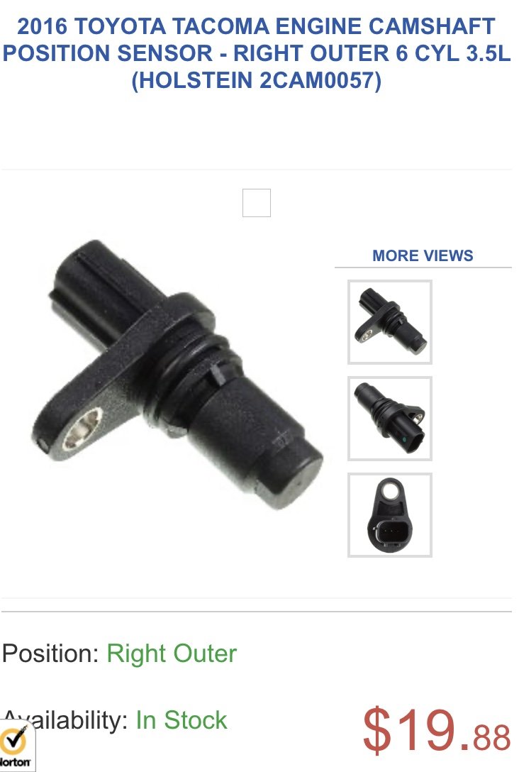

    So here is what happens if you mess up the wiring going into the camshaft position sensor... its $900 from the dealer because they don't sell the small 3 pin connector by itself... its apart of a bigger wiring harness. Shocker.
    Dorman Part # 645-744 is the same 3 pin connector. It was $30. Just splice and solder. All codes went away and it starts right up.
