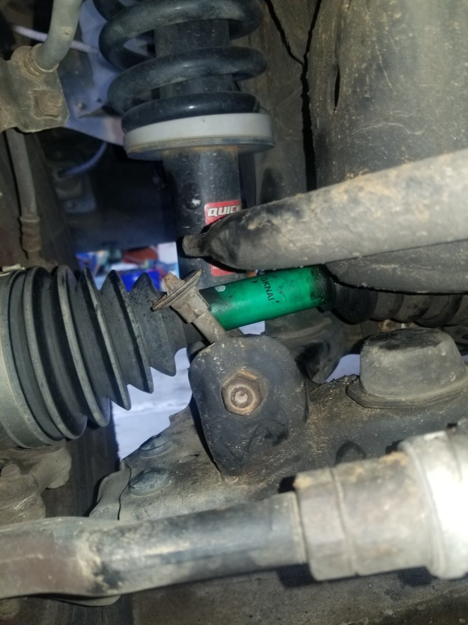

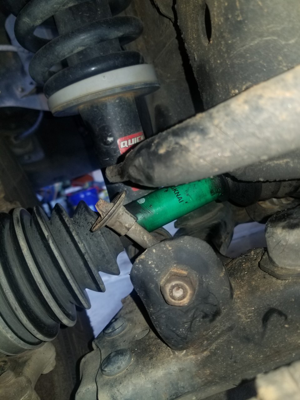

    20220718_181134.jpg 20220718_181130.jpg Can someone tell me what part this is thats broken? Just discovered it and need to drive to work. The bolt in front of the boot

    Sway bar end link.
    You can drive it, just note that you will have more body roll than usual.

    In short: no. It isn't negatively impacting anything other than your driving experience.
    Your sway bar (or anti-sway bar) end links connect the (anti) sway bar to the spindle. It is the only link between your left and right spindles (IE your left and right independent, front suspension). The purpose of the (anti) sway bar is to limit body roll and there are plenty of YT vids out there explaining the purpose. You will be fine running with a broken end link but you will notice your body rolling more than you are accustomed to because your suspension is now free to do its job.
    I upgraded my suspension and the OME 2886 coils I have are considerable stiffer than stock so I just removed my sway bar and haven't looked back. Just don't get too wild taking 90 degree turns until you are used to the roll.

    Not a big deal at all. I broke mine on the trail and drove 4 hours home no problem. Just gives a little more body roll but you won't notice since the truck is IFS

    It didn't really break it rusted out to the point it was so thin it broke get two of them.

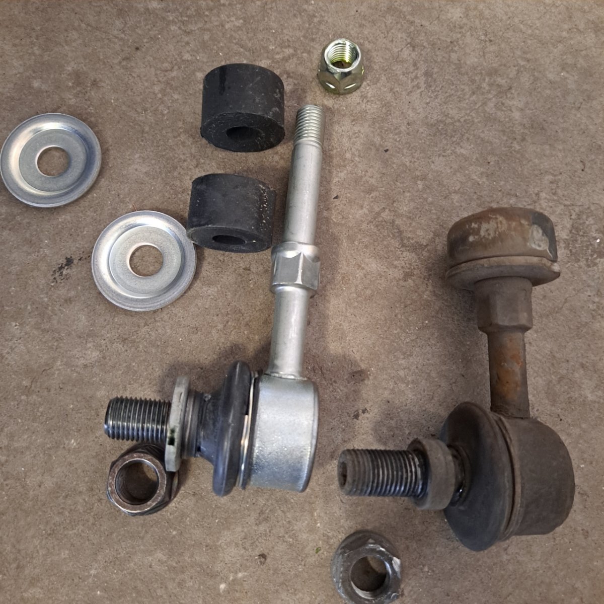

    This happened to me last month and didn’t even know it was broken till I was washing the truck.
    So driving it is probably ok to go to the dealership to get the parts

    These are the parts I needed and my broken part from rust

    Are those Toyota parts? Dealership here wanting 57$ apiece.
