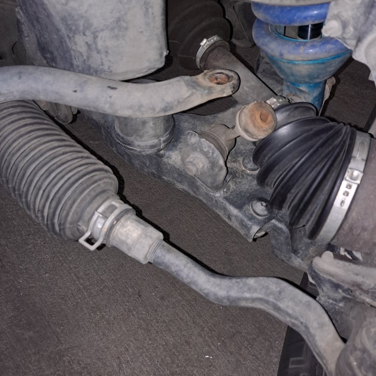

    Interesting that the 3rd Gens moved to an end link set up that mounts to the spindle rather than the LCA.
    Below: stock driver's side front from a '21 Sport DCSB. Please note, rather than try to wrestle and contort the sway bar without removing the skid plate take five minutes and just drop the damn thing. I spent thirty minutes trying to work around what would have taken me 5 minutes, and ended up taking it off in the end.

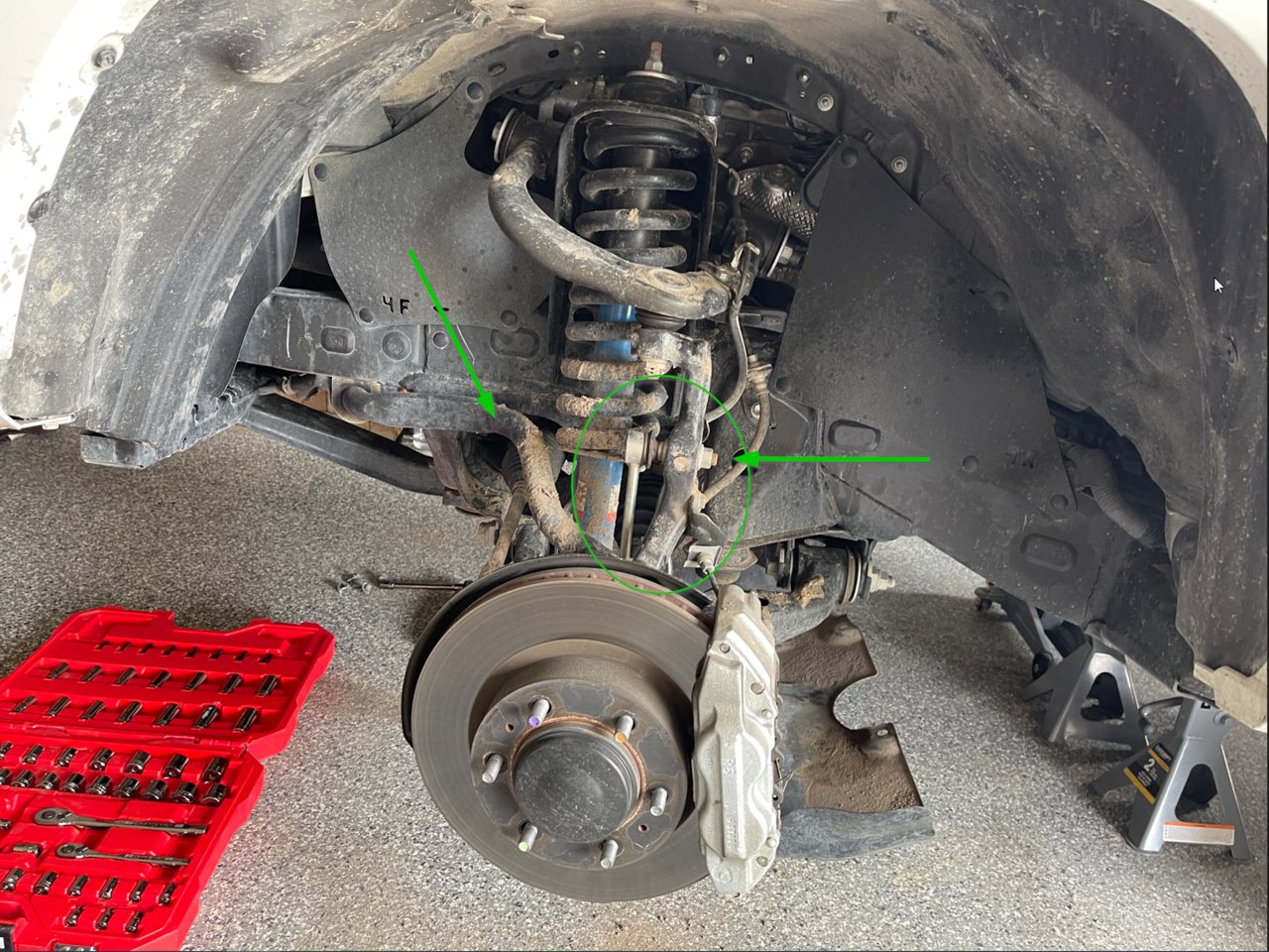

    Post a picture of the ones you got? I have got these from both Napa and Toyota no problem.
    there are different styles of the end links across the first generation, if I recall.
    you have the same version as my 96 which
    Sway bar/stabilizer bar (I think Toyota actually calls it a stabilizer bar) end links
    Napaonline.com part number is :
    NCD 2651650
  14. Jul 21, 2022 at 8:34 PM

    Yes. 95-00 are different than 01-04.
    Otherwise, shouldn't be difficult to find the correct one. The Moog part I linked on page 1 will definitely work.

    Based on picture alone I do believe you are correct an I thank you! Ordered it today so we will see how it goes. Was jus worried about all the negative reviews about the weld but plenty of others were pleased an with the new 5100s an OME 880 coils the suspension will be a little more solid as well.
