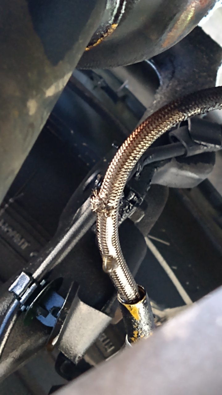

    Is it rubbing on something in turns?

    If it were me, I'd tend to think the damage had been done years ago, and there was an eventual failure.
    Or more than likely - the wife (or OP) drove over something on the road that damaged the brake line.
    ** Disclaimer: THAT is unless I had good reason to suspect the wife was having an affair and wanted insurance money. :cheers:

    Good question. Not that I can tell as I didn't see any raw metal or wear spots under the truck. But I dropped it off at the brake shop yesterday, mainly b/c I'm jusy too lazy to work on it, but it really needed the rear drums to be serviced, too (112k miles and I've never even touched them- but I got 90k out of original front pads!). Drum brakes and differentials are my mechanical kryptonite.
    I told the owner everything and asked him to access what he thinks happened. I'm inclined to believe it really was existing damage from road debris or my time with the maniacs from tee-tee-oh-are-aye and it just ruptured over time. I just have a hard time putting unproven evil on somebody like that.

    All the little easy stuff. Locking console box, led interior lights, bed lights, gas cap holder, wide angle split mirrors, sequential mirror lights,
    Was the truck jacked up for the picture? There are two rub points on yield frame/ suspension in the picture. One is long(to the top right) and one is on an edge ( top middle) that looks to line up with the damaged braiding. I know it upsets a lot of people, but very few metal covered brake flex lines meet DOT standards. They are a trade off of durability for looks. Quality hoses have a rubber coating. It will last far longer when rubbing on a suspension part.
