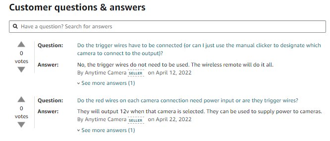

    I see you might have an issue with the trigger wire going to the camera module. Example: the not used door mirror cameras should be taped (insulated) separated. Also, the front camera also has a trigger wire and I don't see what you did to that. The "extra" wire that is next to the front camera connection.
    As far as the middle button on the remote, I'm guessing it's a mode select. I ordered one for myself, have yet to receive it...

    This seems to be same model:

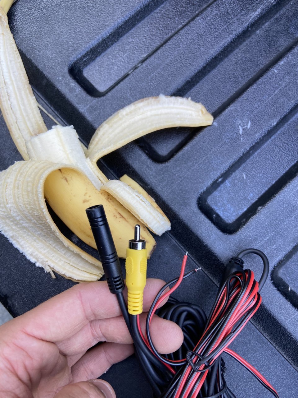

    The not used door mirror wires are separated, just looks like they are connected to each other because I taped them up together after individually taping them up. The front camera has three wires coming out of the its housing: a ground, a positive, and a connector that plugs into the yellow RCA jack. I have the ground going into the ground on the fuse box, the positive going to the fuse box with a 2 amp fuse, and the the last connector going to the yellow RCA jack.
    The green and white are seperated, I electrical taped them up individually before taping them together. heres a pic of the camera wire below. I got the red positive going to the fuse box along with the black negative. Yellow RCA jack connected to the harness RCA , and the male connector plugged into the female harness connecto . I'm pretty sure that is correct? Should I be putting the red positive somewhere else other then the fusebox?

    They way you have the juice going into the front camera means it's always ON. Might not be an issue, but to manage it better would entail adding a switch to select ON/OFF, which the remote modes might do, unlike the turn signals. But without having the unit in my hands, I only speculate on the workings of the module. It's meant to be able to select any camera via the remote buttons, but if the cameras require fused power as a trigger to be viewed automatically, who knows.

    The Red & Blk in the pic is power to the front camera? Does your Home screen appear if you disconnect the Red?

    Try powering your front cam ONLY when you want to view it.
