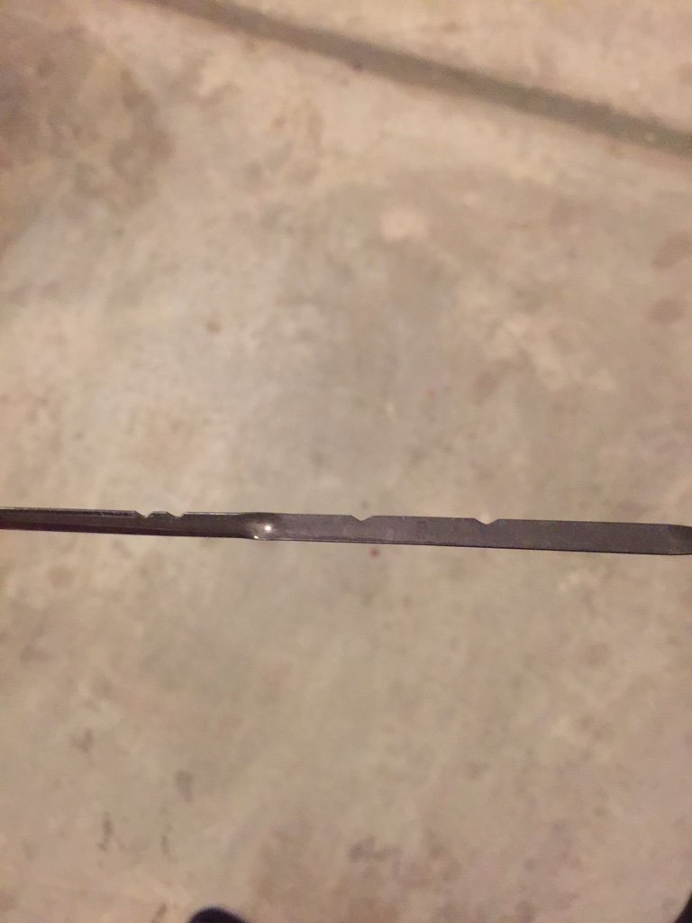

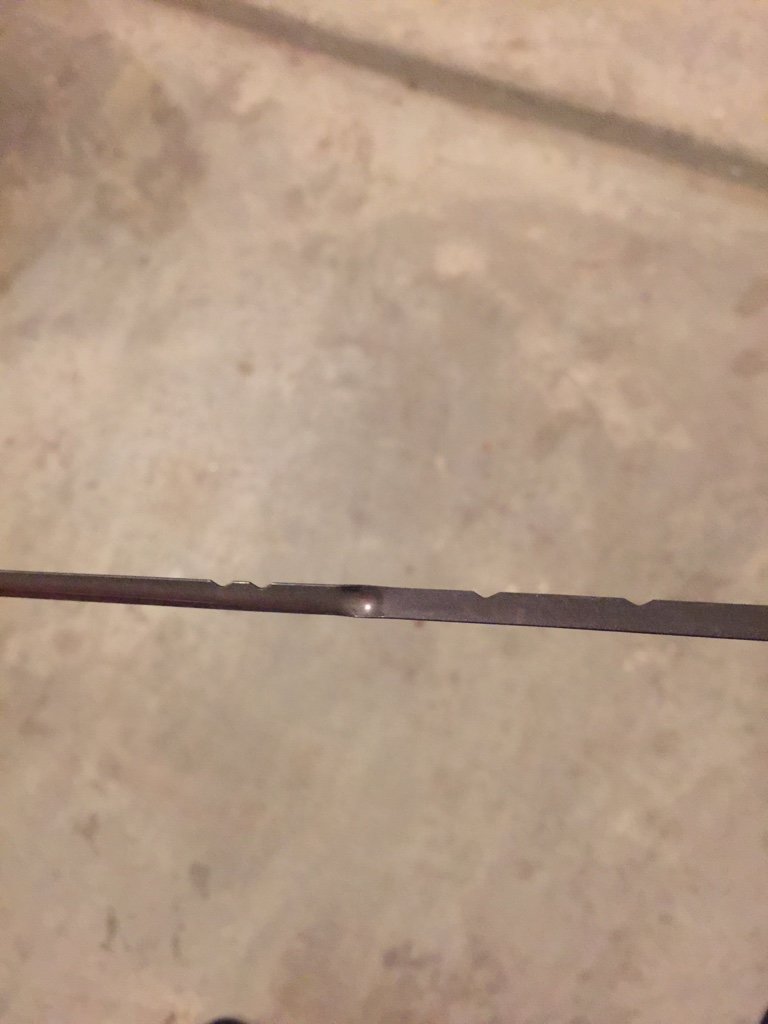

    Ok guys so I checked the fluid following this method
    Park the vehicle on a level surface. With the engine idling and the parking brake applied, shift the selector into all positions from "P" to "L", and then shift into "P" position. Pull out the dipstick and wipe off the fluid with a clean rag. Re-insert the dipstick and check that the fluid level is in the HOT range. Do this check with the fluid at normal driving temperature (70 - 80°C, 158 - 176°F) .
    I turned the engine on and let it idle for at least 10 min until it reached normal temp. I followed the instruction above and I checked the fluid and it showed below the hot marks both times that I checked see pictures. Could this be the cause of the hard shift??

    From the looks of those pictures it looks low since in the manual its states it should be between the hot range, maybe someone else would chime in, but to me it looks low.
