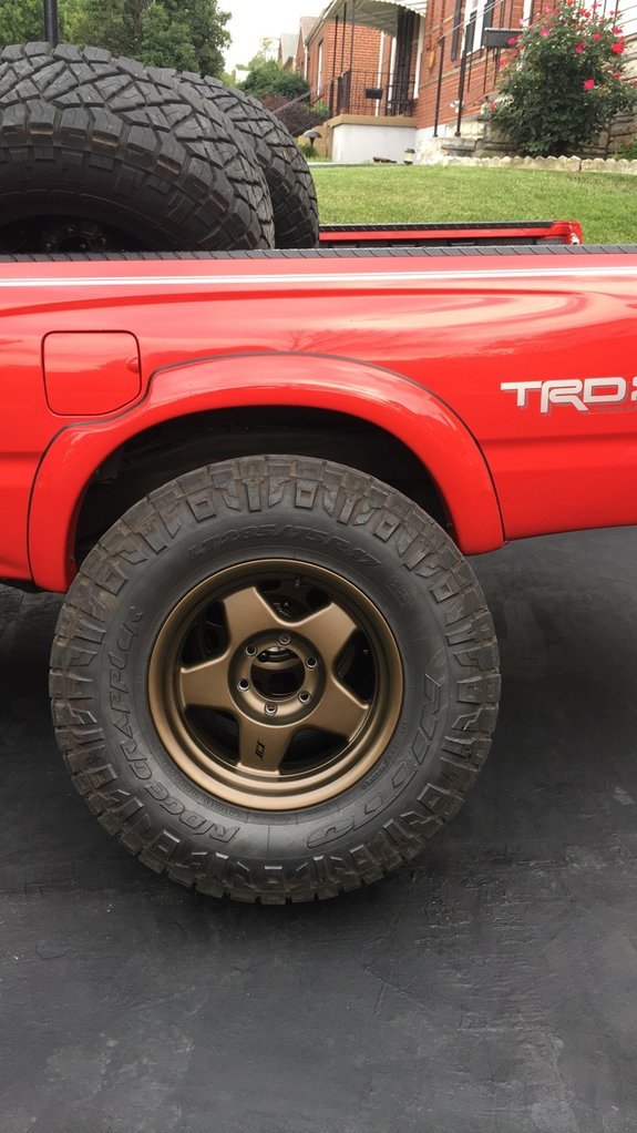

  18. Aug 31, 2017 at 5:46 PM
    #18
    STLTacoma
    STLTacoma [OP] Well-Known Member
    Aug 25, 2016
    #195520
    109
    St.Louis, MO
