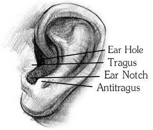

    Yup, anything long enough with a relatively small diameter will work. I've used pin punches, socket extensions, long screw drivers, a piece of rod stock. Like @c212 says, wrap a little tape to make it more comfortable. I find it works best to let it sit on the tragus. That's your word of the day. That's the term for that not quite bone, not quite soft cartilage flap sort of thing covering your hearing hole. A long handled screwdriver with a ball end sits on that just perfect and the sound is very clear.

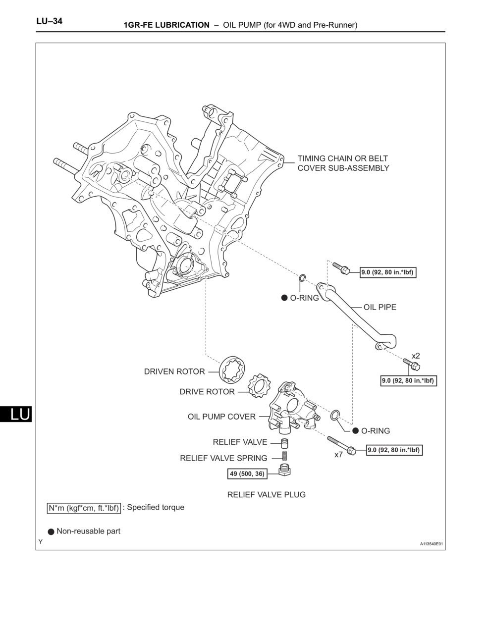

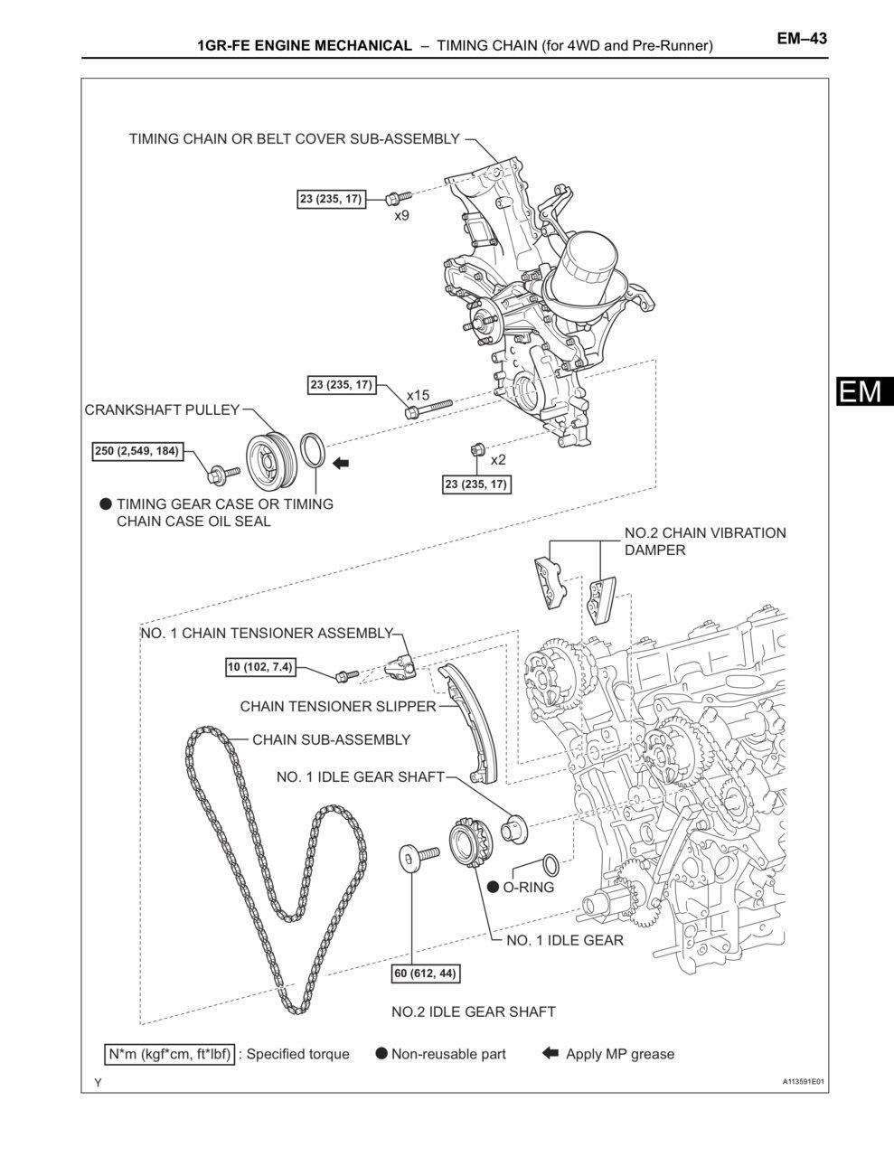

    If you've taken off the accessory serpentine belt and find you can still isolate the noise to the front of the engine here's what would be still turning. The oil pump and camshafts are behind the timing cover and driven directly or with gears and chains. But the typical bearing noise sources, idlers, water pump, alternator, steering pump, A/C compressor should be eliminated without the belt. I still hold out finger's crossed it's throw out bearing noise though.
