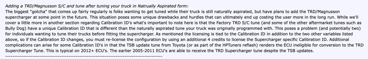

    If you have already flashed your ECU with a tune for a N/A setup, you're going to need to buy a replacement ECU, you cannot flash the BD tune, TRD S/C Tune, or HPTuners tune for a S/C on a 2012+ ECU that has the TSB update or a N/A tune. I've posted that in my HPTuners FAQ that is linked in my signature.
    I can supply you a pre-tuned ECU that is VIN matched to your truck if you'd like to go that route.
