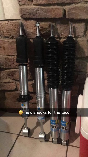

    IMG_0336.jpg Yea has to be like this spring plate (shock on the left)
