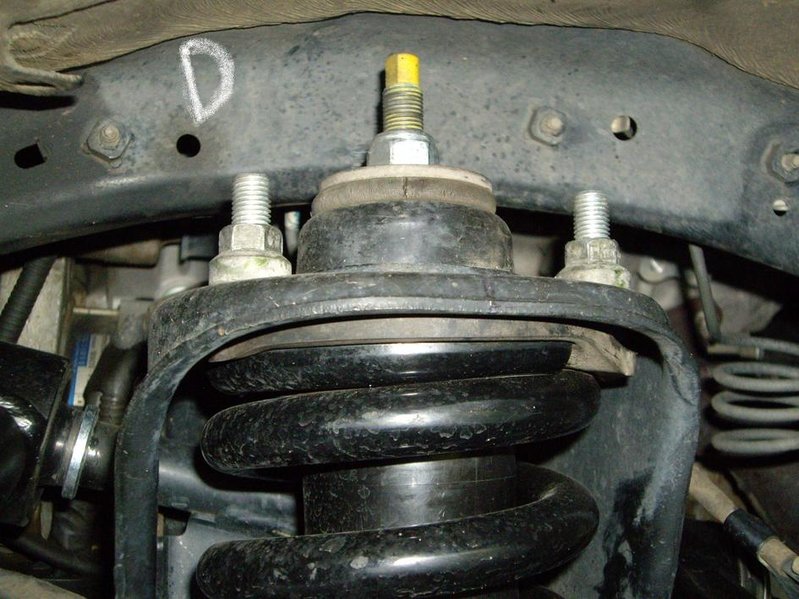

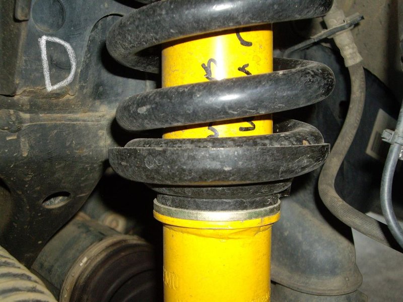

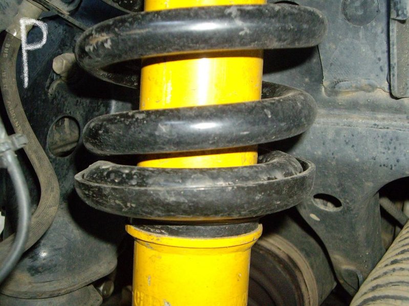

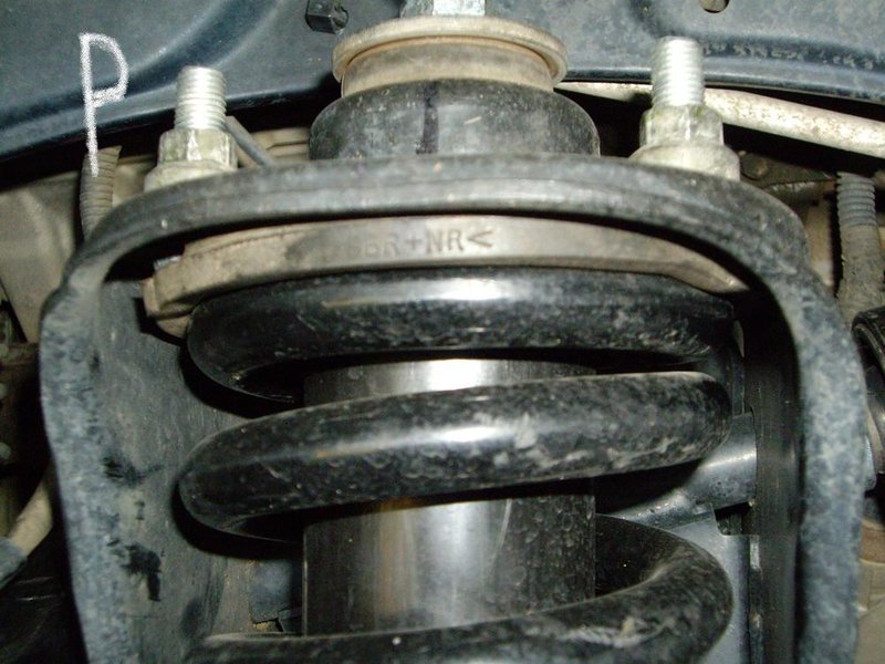

    So I have been having an issue with my OME 3in lift. When I go over a bump like a speed bump, as soon as I am on the down side of the bump it feels like the front suspension just drops down to full droop and I hear a loud thud, like it bottoms out the shock or something. For a while I could not seem to figure out what is going on until "ktmrider" suggested that maybe the coils were assembled wrong. After looking at it more closely it appears that they are, (see below). You think Midas would be better than this.
    P.S. I had planned on assembling them myself but no place in twon rented a compressor that was large enough for these coils.
    So which side is assembeled correctly? I have labeled the pictures with a D and P.
    Thanks for all the help! Now I get to complain to the manager and tell him he needs to fix this for free, yay! I bet that will go over smooth.

    I don't think that these look any different than mine...What is the problem you are seeing??

    It don't look wrong from the pics what coils do you have? Do you have a lot of extra weight in the front?

    What coils are you running? Assembly looks ok as far as I can tell.

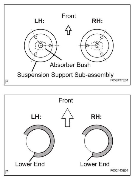

    I don't know if it holds true for the OMEs, but the factory springs are installed with the bottom ends of the springs oriented towards the rear of the vehicle.
    I assembled my Bilsteins using the attached diagram from the 06 FSM. If the OMEs are typically installed as indicated by the diagram, it means that your driver's side spring is 180 deg. off. But again, I have no knowledge of the correct installation of the OMEs, or if reorienting the spring would make a difference.

    One of the coils has the flat part towards the top and the other has it towards the bottom. I forget which way is correct.
    EDIT: Actually they look ok, maybe just oriented wrong like previously stated

    After seeing the pictures they look just like the ones on my truck right now.
