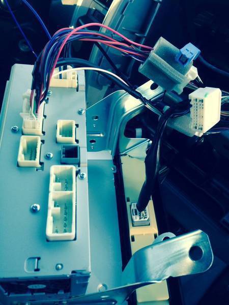

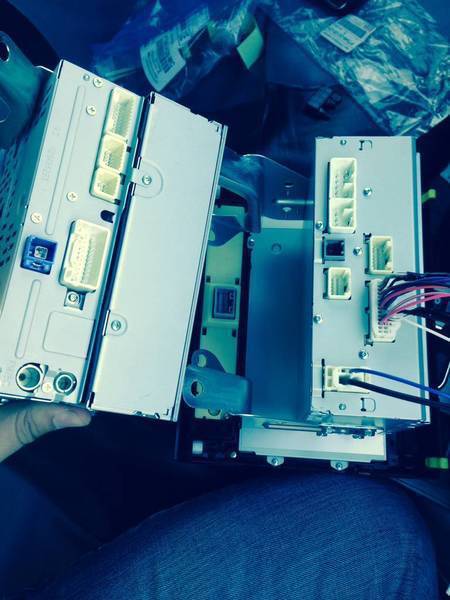

    So today I got stuck trying to install my 2013 non JBL touchscreen to my taco with JBL from what I read here I got all the harness and Bluetooth connections but my speakers/power connection don't fit or the blue cable.
    Any help would be appreciate. :eek:
    As you can see the speaker/power cable and the blue i wasnt able to connect it to the new unit. on the unit the blue connection is grey color. the male speaker cable is different connection.
    09 JBL stock radio
    09 JBL stock radio left and 2013 touchscreen right
    here is the big rectangle (power supply?) male connector

    Sorry, I'd like to help more, but I can't quite figure out what you're trying to plug into where.
    How is your relationship with your local Dealership? Sometimes just going by there and seeing if the service guys will take a look at it will work. They'd be able to tell you if you have the right harness or if it will work without cutting and splicing wires. When they did the buyback on my 99 the service manager had one of his guys pull my Sony head unit and put the OEM one back in for no charge.
    What model touchscreen are you trying to put in. You might see if Crutchfield has an install kit, or the wiring harness adapter.

    Looks like im going need JBL system harness to be able to connect my stock (speaker/power) harness to the new touchscreen unit if theres one out there, i just hope i dont need to cut anything.

    Maybe someone else has a different idea but:
    I think your going to need this: http://www.crutchfield.com/p_127TATO/PAC-TATO-Wiring-Interface.html?tp=3486
    This is to install an after market stereo. The speaker and power wires are without connectors. You might be able to get Toyota 10 and 6 plug housing connectors. Part numbers 90980-10996 and 90980-10997. Get the terminal connectors also and wire up accordingly.
