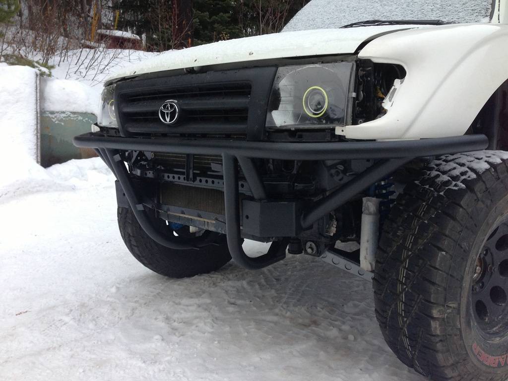

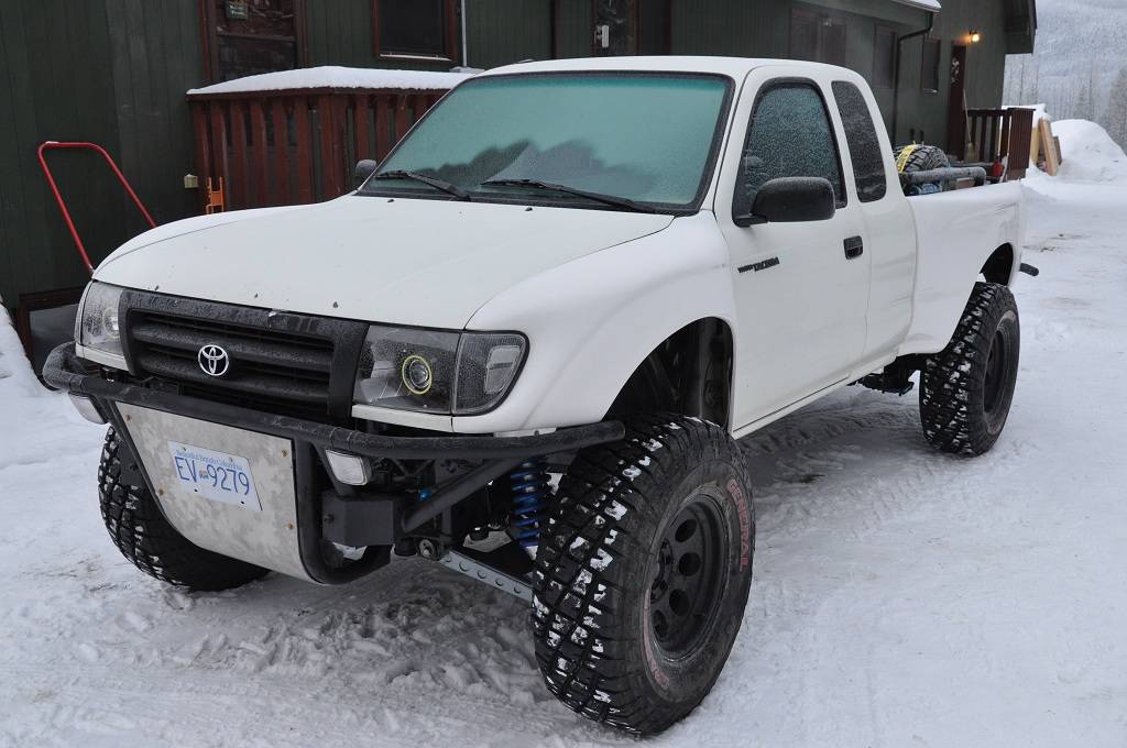

    Hey guys i have just bought a 99 4x4 Xtra Cab Tacoma and the first upgrade im wanting to do is replace the stock factory headlights. Just dont do the just well enough at night. So im wanting to put some kind of projector headlights in it but i dont know how they will look because my truck is white and all the pictures that i have seen are of either black or another color other than white. Was wondering if any of you guys our there had a 99 white tacoma i could so how the headlights look on just cant decide.

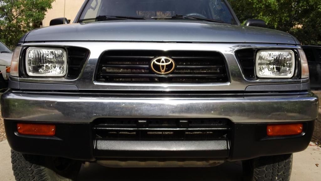

    Rampage halogens Custom bed rack
    My 97 Taco oem's were cracked when I bought it. I opted out of all the LED/HID/Projector stuff and put in Rampage halogens. Went in super easy, and I am way impressed with the brightness of them. I took it out on a dark road after install and those bad boys are throwing light way down the road when on high beam. Cost me $80. My Taco is not a '99 and not white, but for me I thought I'd rather put the money in other upgrades right now.
    http://www.amazon.com/Rampage-5089927-Rectangular-Headlight-Conversion/dp/B001FVFVW0
    Of course you don't get the "aw cool" factor of halos and all that, but they do the job and imo look good.

    If you put and hid bulb in a reflector housing you will be blasting light up and down and blinding every driver. However if you go the projector way is does not do that.
    Also from theretrofitsource.com faq page
    "Power is nothing without control. Retrofitting is the process of installing a xenon or bi-xenon projector into a reflector based halogen headlight. It is the best HID headlight upgrade possible since the projector will control the light into a properly dispersed, non-glaring beam pattern"
    If you do the headlight right it won't send light everywhere.
