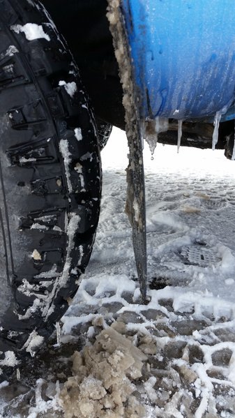

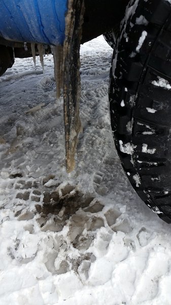

    So I dont know why but I have way more clearence on my passenger side than drivers... If you take a look at those pics there is like a good 1 inch difference between both sides... What can cause this?? Hub to fender on driver is 22 3/4" and passenger is 23 1/4". Thanks for your help.

    Caster difference?

    It can adjust the position of the wheel inside the fender well, so more caster = tire closer to the front, less caster = tire closer to the rear.
    Likely you just need an alignment and your caster is out of whack on one or both - but it's definitely not the same on either side.

    Additional caster on the right is common to offset road crown.

    I would need more caster on driver side since when i turn the wheels the tire is touching the fender? And I got 31.6 tires.

    Definitely get a re-alignment

    Anyway I will defenetly have to check it out with a mechanic
