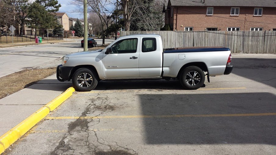

    You can likely go as tall as 235/75R16 without a 2.75"/1.5" Level/lift kit installed. That's a 29.9" tire. You're 235/60R16's measure in at 27.1". OEM stock tires of 215/70R15 ran in at 26.9". You will need a fender-well box delete, which is simple.
    This is my truck, several years ago. 16x7's, 225/75R16's, no level/lift kit or fender-well box delete at this time.
    Edit - I would suggest going to a level/lift kit and quality shock replacements, which should enable you 245/75R16 at 30.5", albeit at a final-drive gearing cost.
