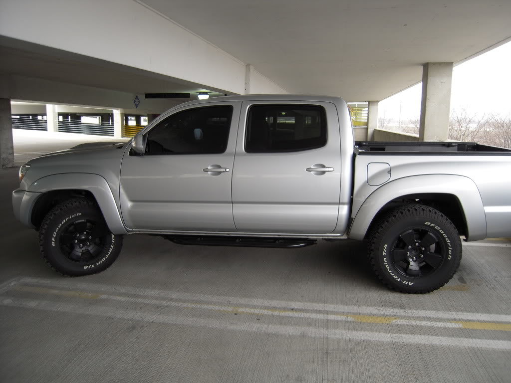

    whats up man...pretty easy to do...take your wheels off and use a wire brush, high grade sand paper or you can just use a scotch bright pad to scuff the wheels up. I used high test caliper paint (satin black $7 a can). Its a lot more durable. Then just clean the wheels really well and tape them off so you don't get overspray on the tires. I used blue painters tape and newspaper.
    Then just lightly do 1 coat and then 2 more coats to get every area covered. Let them dry and don't put the wheels back on right away. The paint will be a little soft and your tire iron could slip and chip it a little bit. Heres what mine look like.....good luck! Post some pics when you get done.

    Tdubd_ thanks for the info and pic..I am starting mine tonight...Put some pics up by Monday.
