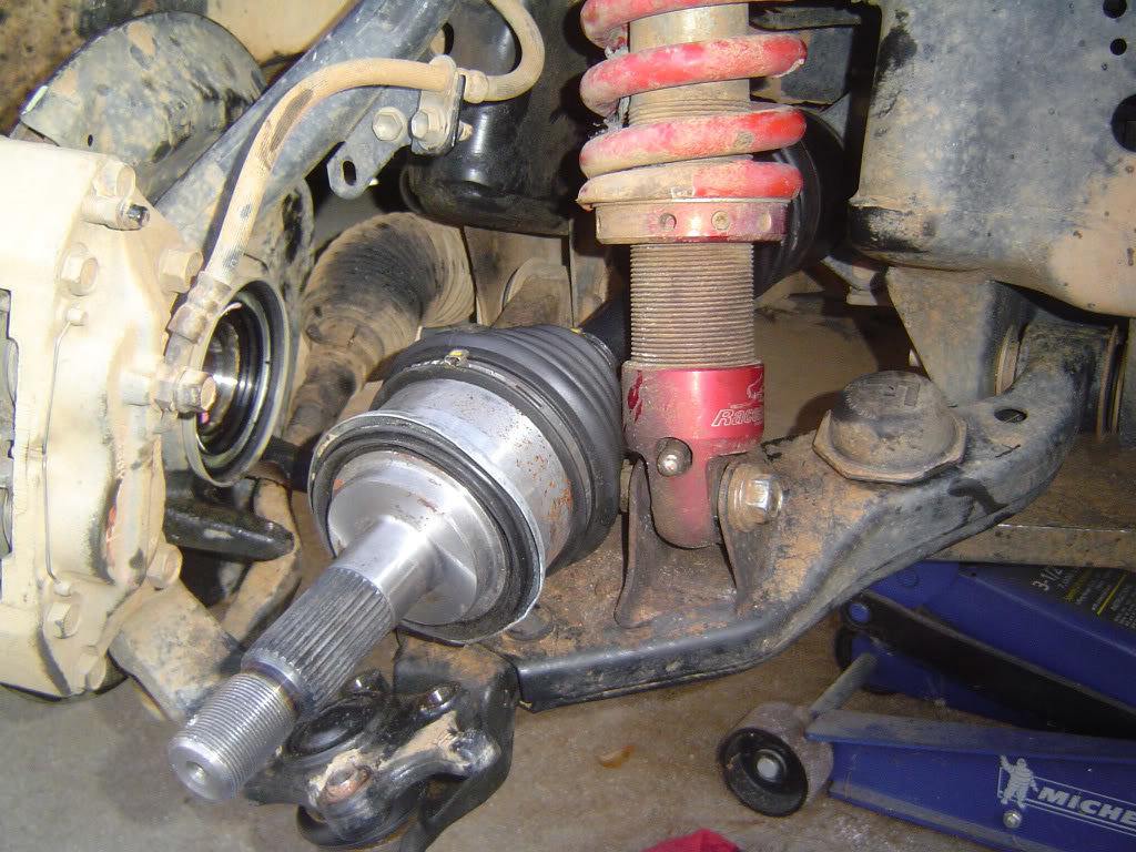

    Just pulled this pic off google, but see that dimple on the very outside of the CV before the threads? Just stick a punch in there and give it some taps with a mallet. It works well if you can tap it and have another set of hands sort of rotating it and pushing it in
