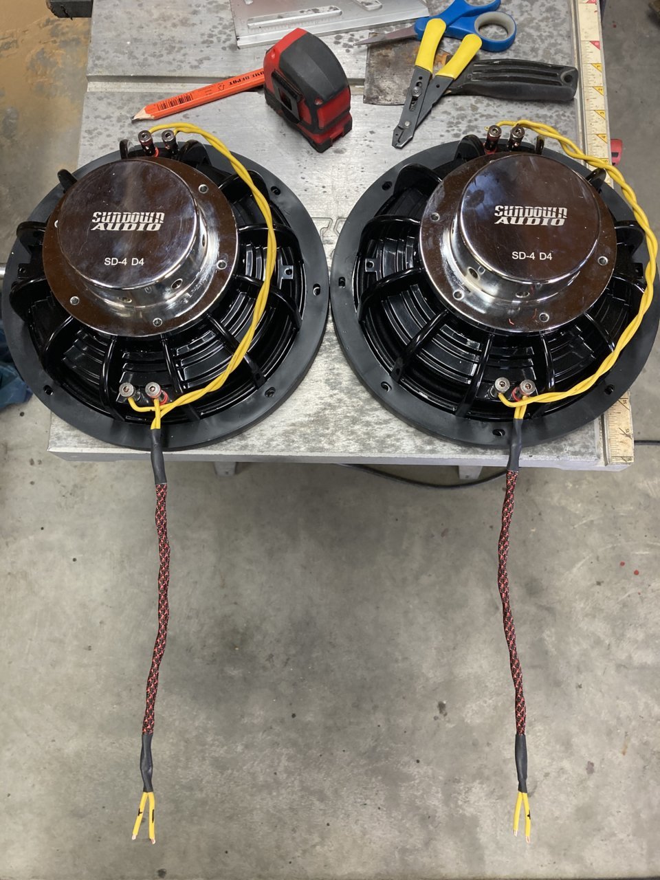

    SD-4 12 D4

    Yeah I’ve got 10” SD-4s on the same amp. My box has to be smaller, but the 12” calls for up to 1ft ^3, so it seems like the right fit for what you are doing so I figured I’d mention it.
    I had to EQ mine a bit because the response didn’t end up flat but they definitely take a beating and reproduce strong bass.
    I think I set my amp at 69VAC, but I’ve got sub set to -3dB (maybe -5dB) because I have Accubass active, and I cut 63Hz like 4dB.

    I ended up ordering from WoofersEtc. IDK if they ship to Canada but even through their site is 14% sketchy, it turned out the service was excellent.
    I’d say the burned coils was caused by heat. Kenwood receivers are pretty good about not putting out any distortion (the XR models don’t at full volume). You can verify with a scope or something like the DM-RTA. The JL HD amps don’t have that dummy light unfortunately.
    The Alpines have a deeper mounting depth than SD-4 subs, IDK how tight they were but they do have a pole vent through the magnet that might have been struggling.

    The mounting depth is close, but SD-4s are more shallow and don’t have a pole vent.
