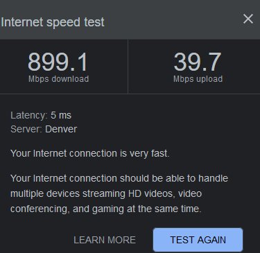

    Wow, your laptop is not getting much. Via hardwire to my laptop, here is what I am receiving when I just ran a test:

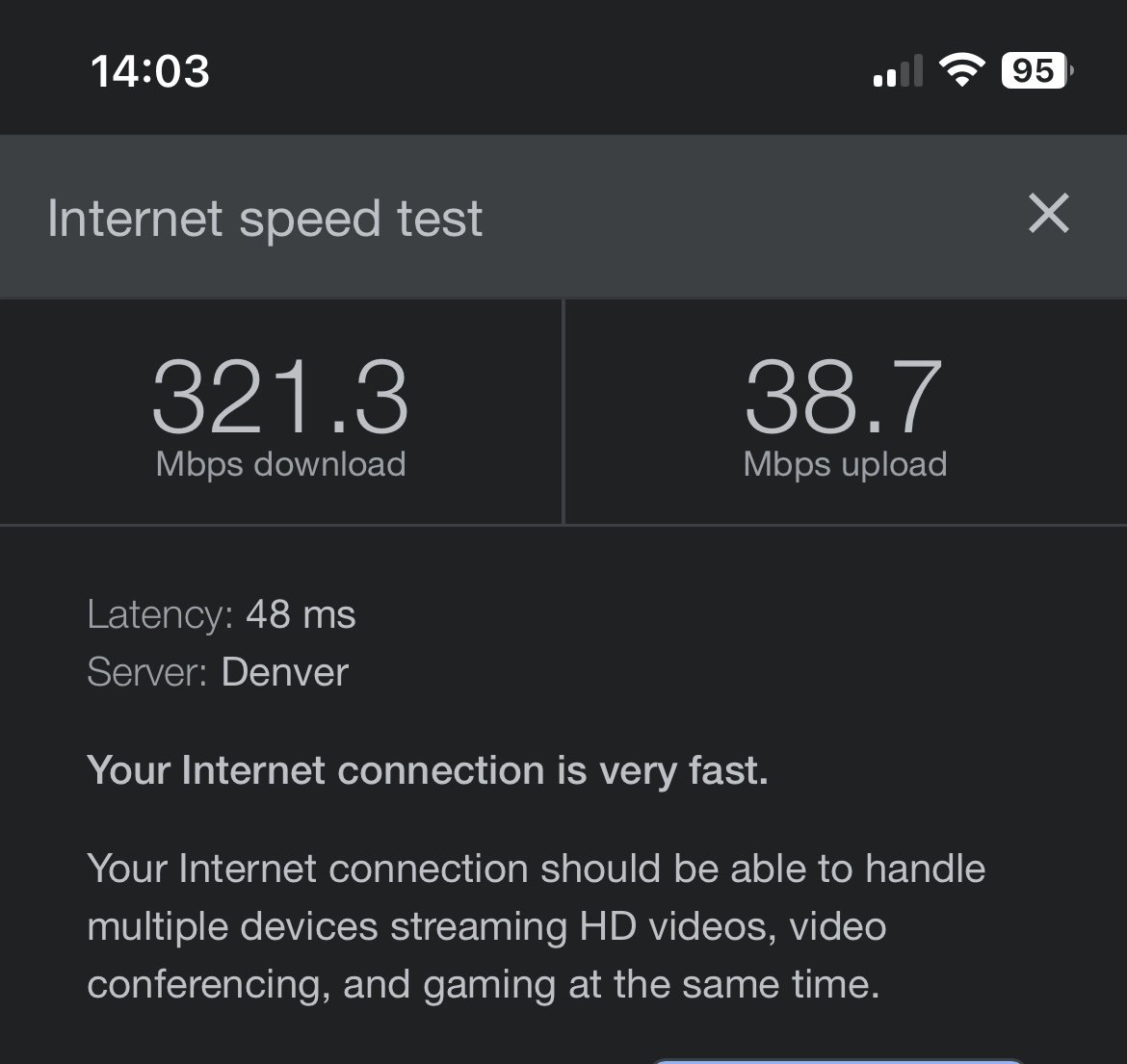

    Ran a test on the iPhone, wifi:
