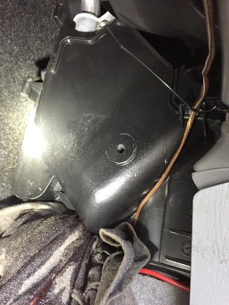

    you drilled your heater core............That's gonna cost a lot and hopefully you hit a line instead of the core thats cheap! OMG! Don't use the heater and may have to clamp outside at firewall to stop from spraying into the cab at high pressure HOT temps.

    I dont know. it depends on how much time it takes to remove and install a new one. let me see hang on

    Heater Core, R&R or Replace
    2005-13 skill-(4.5)
    w/AC ................Labor Time (6.2) hours and a mechanical skill level of 4.5 on the difficulty chart!
    Looking at your carnage it looks like you were pushing pretty hard when the drill finally went in. The chuck bottomed out on the cover there.
    If you hit one of the lines you could use aluma weld rods if its aluminum but either way you have like 2 hours of disassembly to even see what you have done.

    HEATER CORE
    Mfg. Part No. Price (MSRP)*
    8710704060 $370.00+
    ALSOOOOOO
    Notes: Does Not Include: Refrigerant Recovery Or Evacuate & Recharge AC System. not a fun job man i hate those and wont do them. I farm them out of my shop.

    Any luck yet man? were hoping for ya. Im hoping you hit a line and can seal it up without removing the hvac\evaporator black box.

    If it was my truck, I reckon you have several months before you have to address it seriously. Bypassing it is my old trick when the heat is not needed, not sure where you live.
