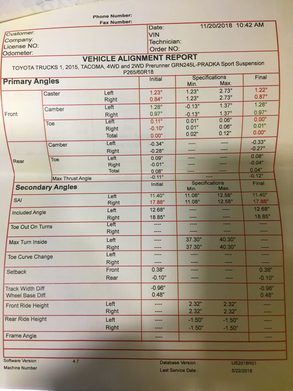

    They said they can only adjust so much with stock UCAs after lifted. With my little knowledge abt these I'm lost here lol. My concern is that I'm just gonna keep aligning so many times to the point where I can use the money to buy aftermarket UCAs .

    No I meant they said they can only go so far on pos/neg on camber with stock uca after lift ( may be that's why they can't get to 0. So now I'm thinking if the aftermarket uca provide more caster ( to positive) then that means more room to 0/neg on camber right?

    Looks like they only touched the toe. Find a better shop

    Aftermarket will get you more caster, but not at the expense of camber like the stock setup.
    You can get 0 camber and 3 or 4 degrees caster at the same time because adjustments are made on the top and bottom.
    On the stock arms you give up caster for camber and vice versa.

    They didn't even try to improve it. I find it hard to believe that there was no room for improvement. Post pics of your alignment cams.

    @Muddinfun the pic is on the top. They might be able to

    There's no pic of the alignment cams. I'm talking about the lower control arm eccentric cams, so we can see if the front ones are all the way in, or all the way out and same with the rear control arm cams.
