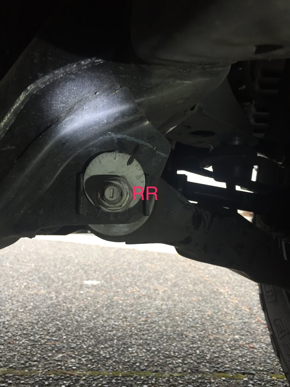

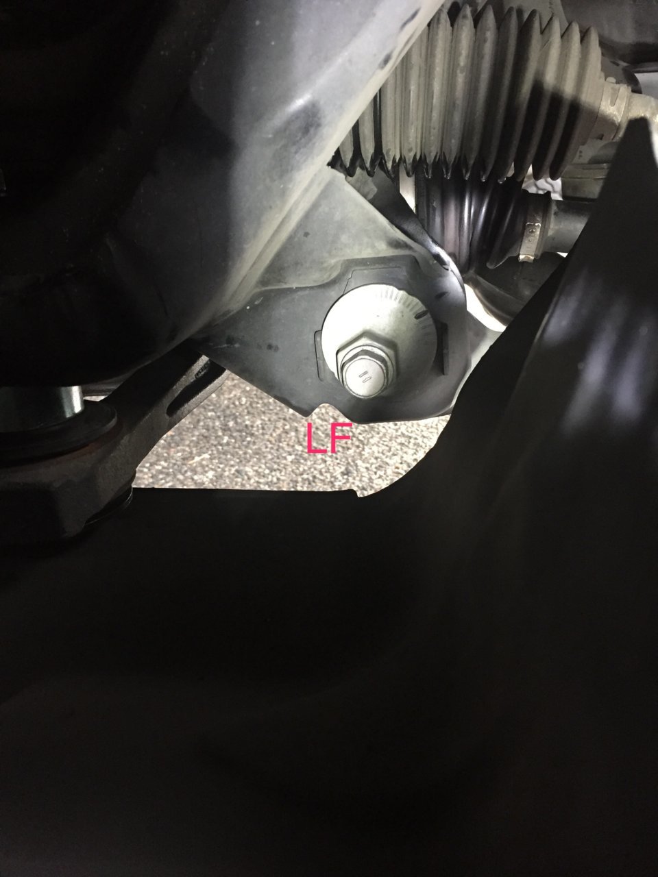

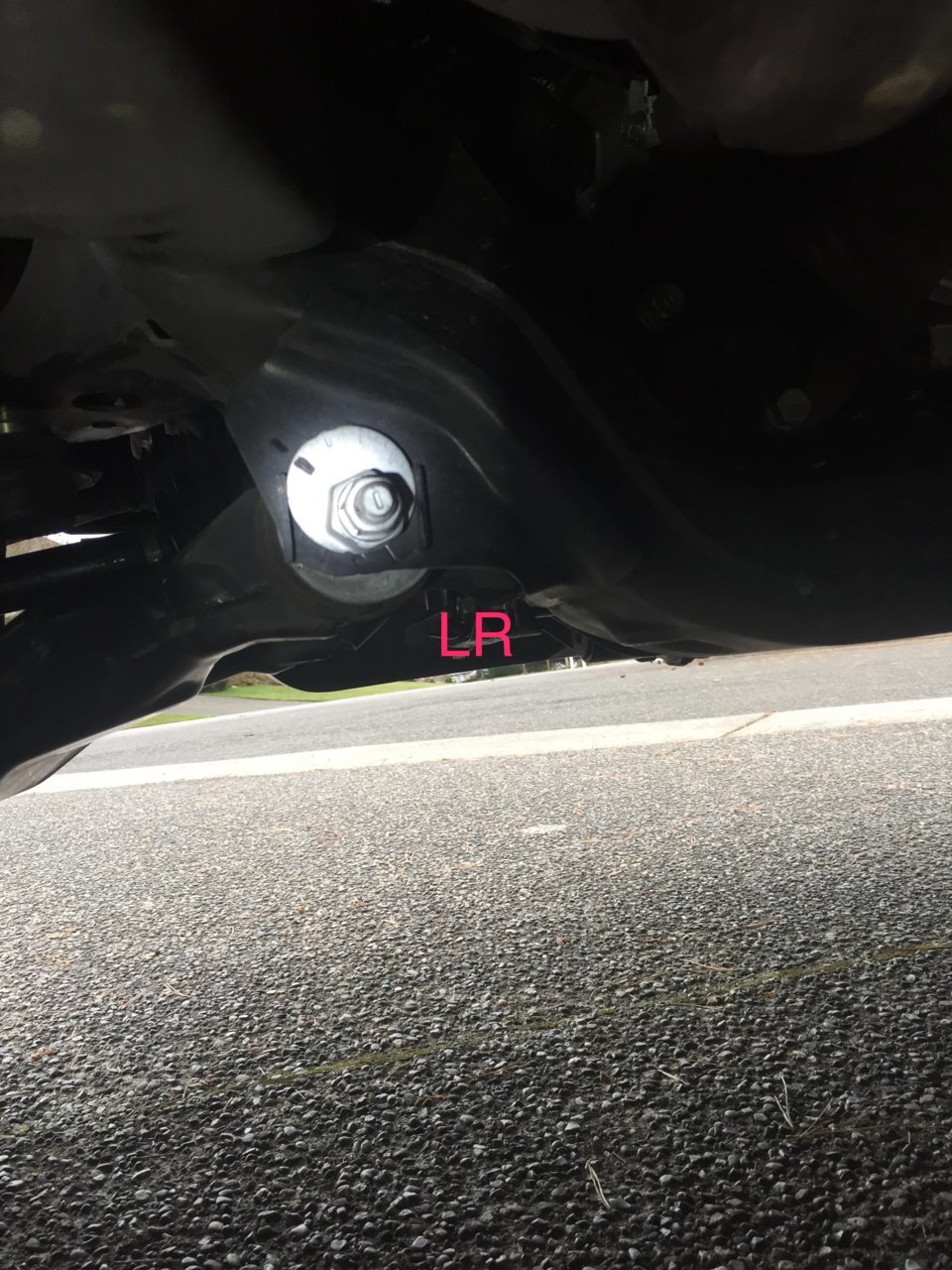

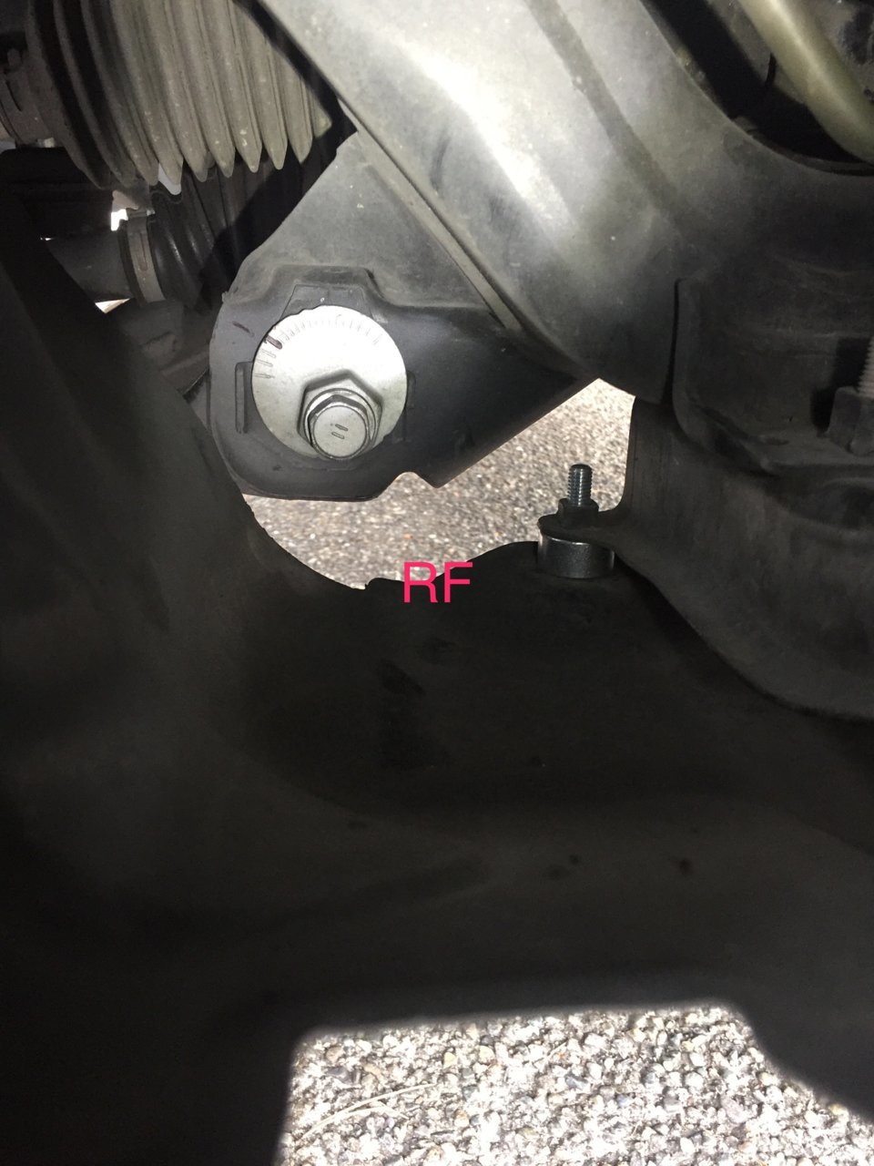

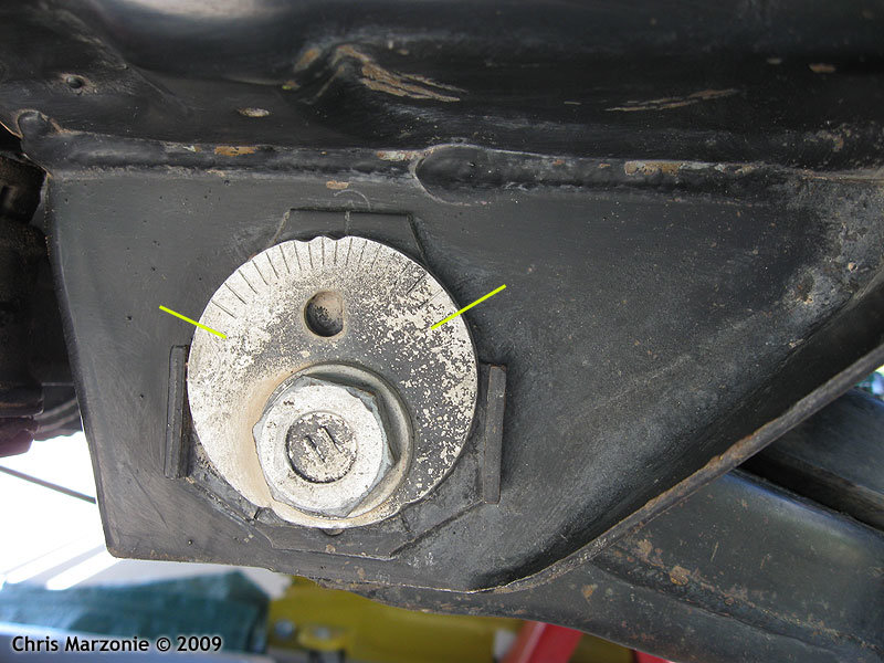

    Need 4 pics. One of each cam.

    You're not getting it. This is an alignment cam. Your truck has 4 of them. The cam in this pic is at the midpoint. There is room to adjust it in or out. The 4 cams are rotated to adjust caster and camber. Based on the position of your 4 cams, we can tell if they are at the end of the adjustment. Be sure to lable the pics. LF, LR.

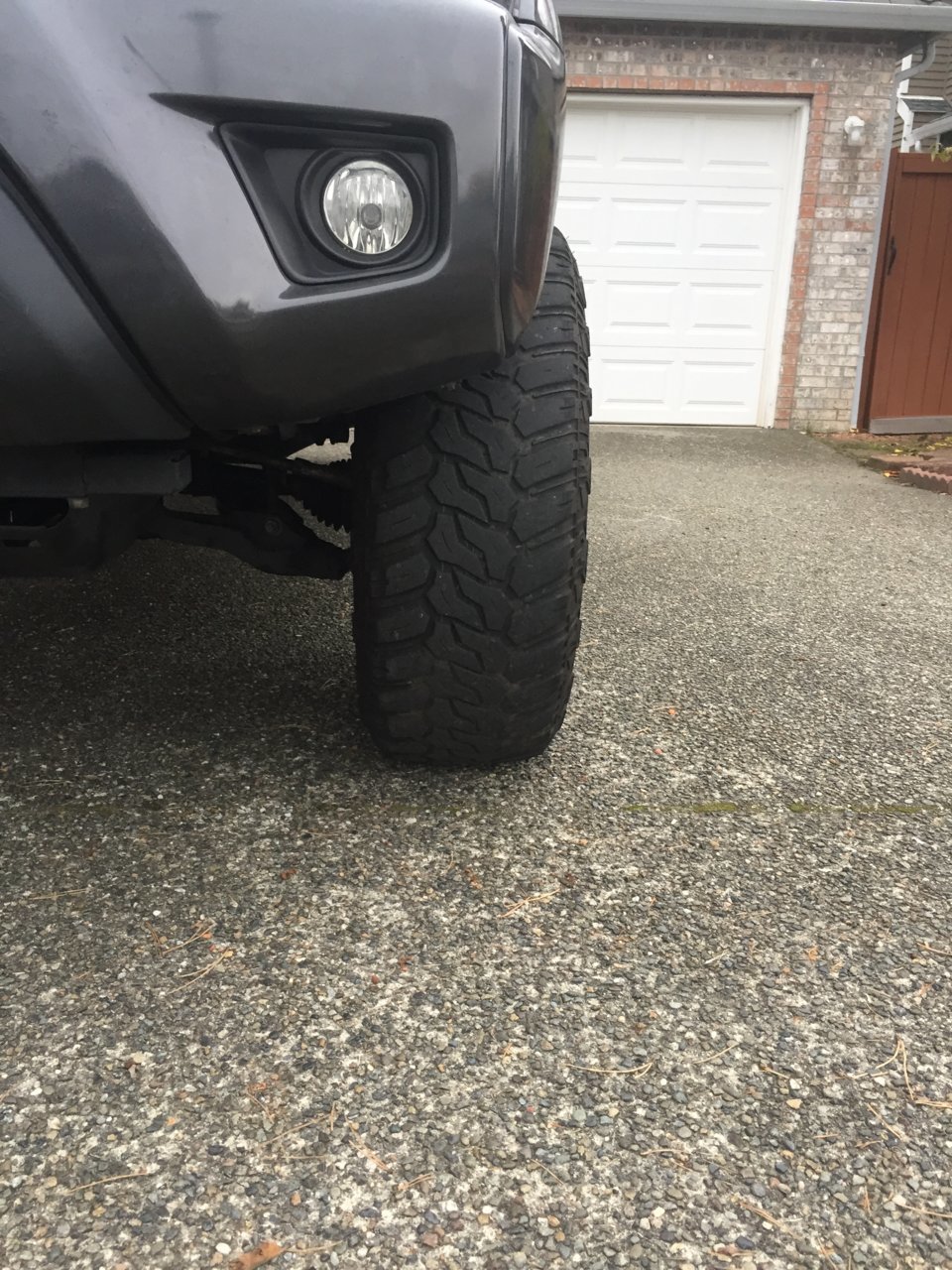

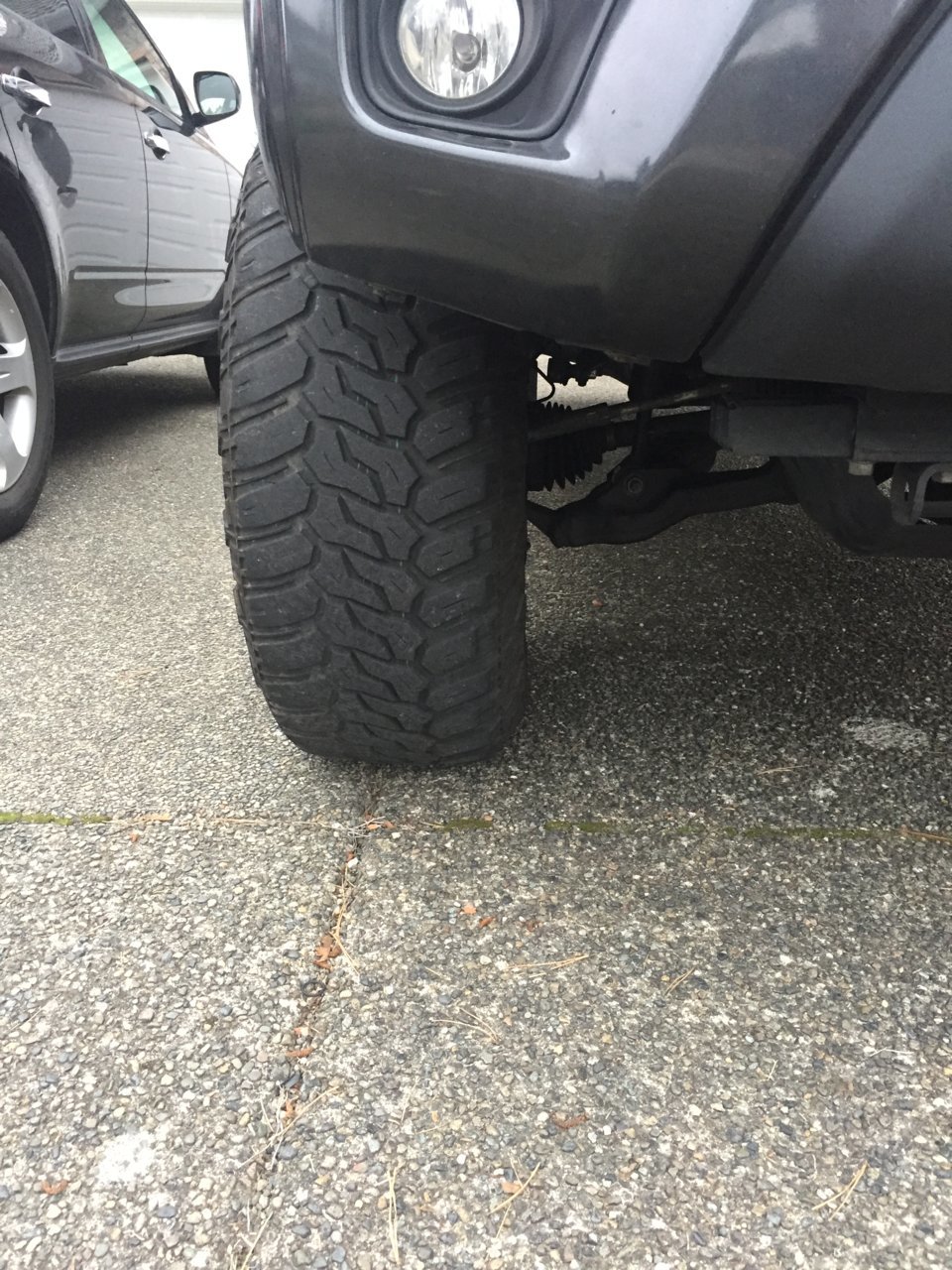

    Just as I suspected. They didn't even try!!!!!!
    To start with, there is a lot of room to move the rear cams outward which will decrease camber and increase caster.
