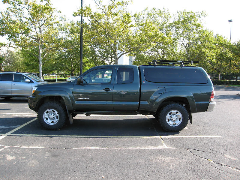

    Tylan
    Tylan Active Member
    Dec 22, 2010
    #48060
    35
    Tylan
    Wakefield, MA
    2012 DCLB Nautical Blue - "Bella"
    Weathertech Floor Liners, Access LightRider, 235/85/16 DuraTrac
    It is crazy how different each of these are! This is me with the Billies at 1.75" and just the TSB Rear Leaf, nothing else. I am barely level or even slightly nose high...
