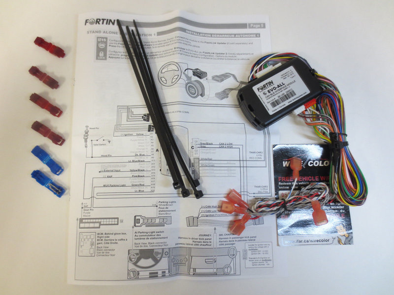

    so I've got everything connected to the right wires still won't start!! What else do I need to do after the Install

    Sucks you're having issues. A little more info would help. Which kit? And I'm assuming it's the push start since you have a sport?

    Yes it's the push start kit I grabbed off eBay.. preloaded for tacoma followed all the correct wiring instructions.. do I need to pair it with the remote somehow ?

    No pairing on any kit I know of but since you don't give any details other than something off of eBay it's tough to give any specific help.
    Double check all connections, review the instruction steps for after install, and of course contact the seller for suggestions.
    In the absence of any other info my first guess is maybe you didn't fully follow the initial start procedure in which the module learns your key.
    Second guess would be a bad module.

    Its a fortin evo-all.. i followed the instructions.. i think they may have forgot to flash my module. I may have to relearn the module. will try again later...... had to take a time out and take my kid to a party so the eBay seller lied to me.. it was not even programmed yet!! I programmed it before it got too dark and voila!! Works like a charm!
