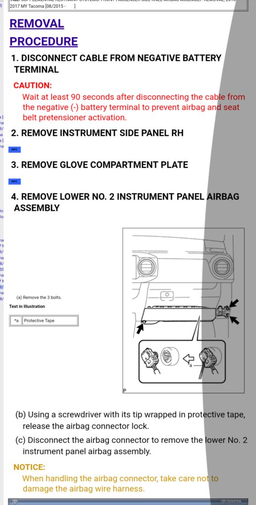

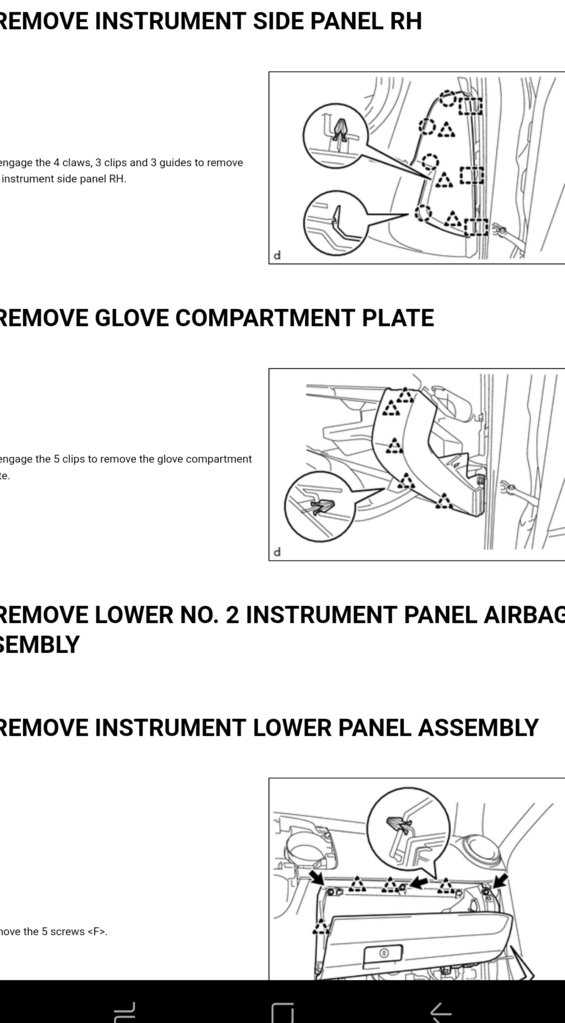

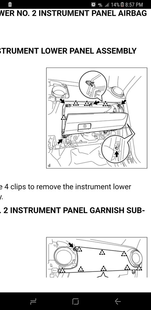

    You have to remove a few bolts underneath, and one hidden behind the side panel on the door side, and the panel by the passenger’s right foot. You can see the bolts clear as day with a flashlight. It’s at a very odd angle and you’ll need an extension to get the bolt out. Then it’s clipped into the panel above it, so pull it straight back to clear the clips, then it’s removed.
    No worries in removing the airbag, just leave the wire connected. There’s enough of a service loop to set it on the floor once it’s unbolted and it’s still connected. Also reinstalling it, there’s like alignment tabs so you can’t mess it up.

    After you remove those airbag bolts. The airbag panel is held in place by couple of tabs along the top. Stick a plastic pry tool and flex the panel down. You will be able to see those tabs between the upper air bag and lower portion of the glove box.
    To the far left of the airbag there's a small. Plastic. Panel. That panel needs to come off to get to airbag bolts
