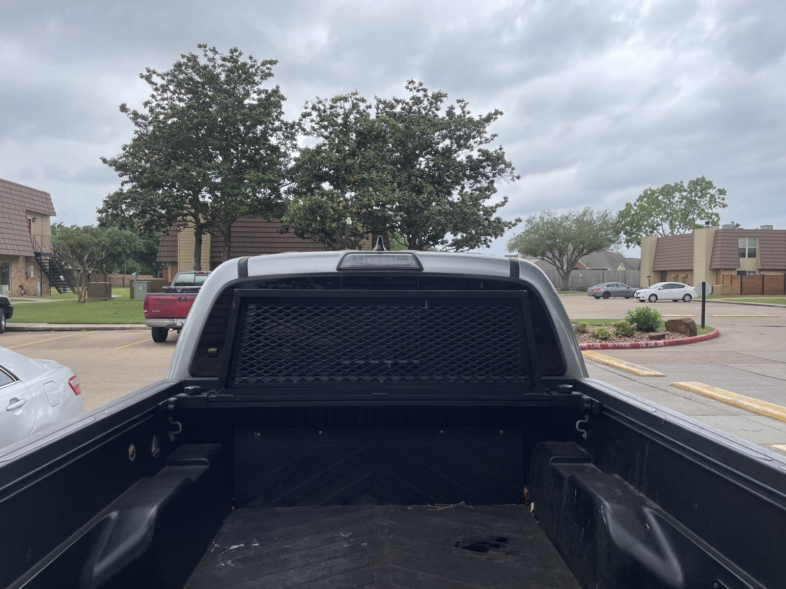

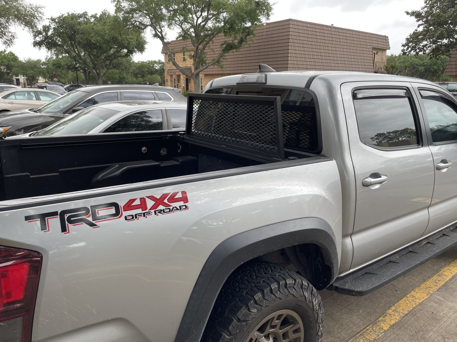

    Strange question does anyone know if these dividers can be mounted upside down

    Ah! A cargo MULTIPLIER??!

    2023 TRD Pro, Solar Octane, 6 speed Manual
    Predator Steps, OEM Tonneau
    If you mean reversing the mounting brackets so that the top knobs are underneath rather than on top, the answer is yes. I have mine mounted that way so that I can use it with my OEM tonneau cover in place. It is a great combination and keeps all my cargo in place no matter how much I load. I just slide it back or forward depending on my load. I highly recommend it.

    No I mean literally upside down almost like a sliding headache rack lol

    Well I got one for a 100 bucks on marketplace. And answered my own question. While it doesnt cover as much as a headache rack, it does rotate out of the way without having to remove it.
