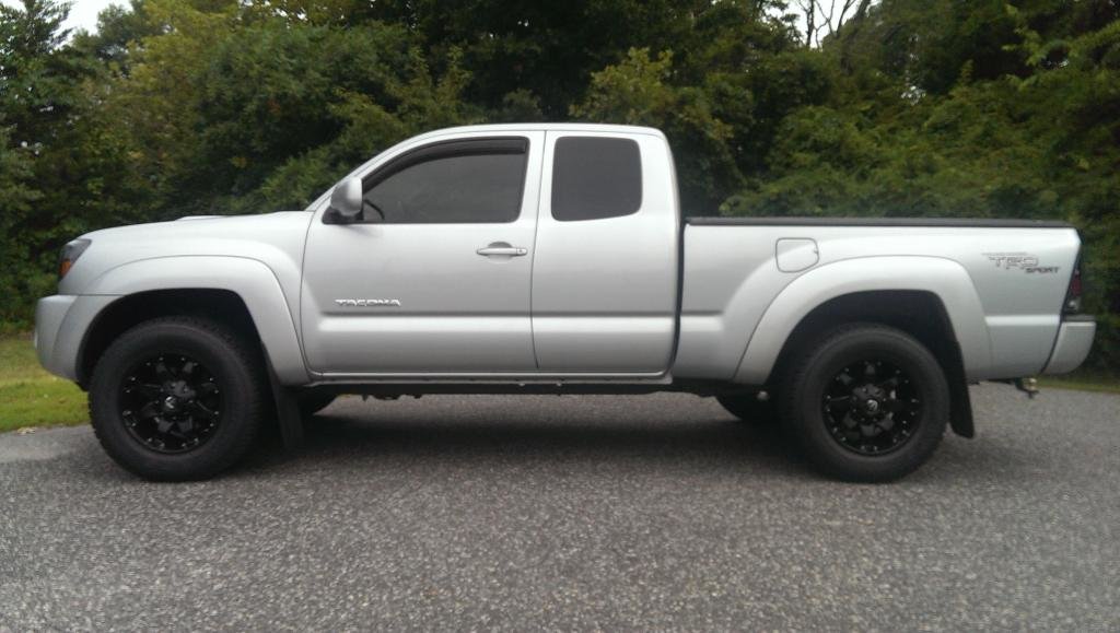

    I have no idea how your gonna make that size tire work. What made you buy that size tire?
    Can you return the tires?
    I also have a pre runner...I went with 17x8.5 wheels along with 265/65/17 geolander ats
    The stance is aggressive but not overly crazy
    Im getting tons of compliments. I had 18's but they were just too heavy and killed my mpg's

    That looks awesome! I got the tire for a deal I couldn't pass up and figure even with buying new wheels I would still come out ahead based on the deal I got on the set of tires. I really need to find a way to make this work.

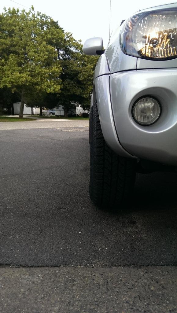

    Return them or sell on eBay...
    Thanks for the comment
    The +14 offset with the 17x8.5 wheels is perfect for the stock pre runner
    I actually gained a few mm of inner clearence
    And the Geolander ATS tires...WoW! What a great all around tire
    Looks great rides smooth
