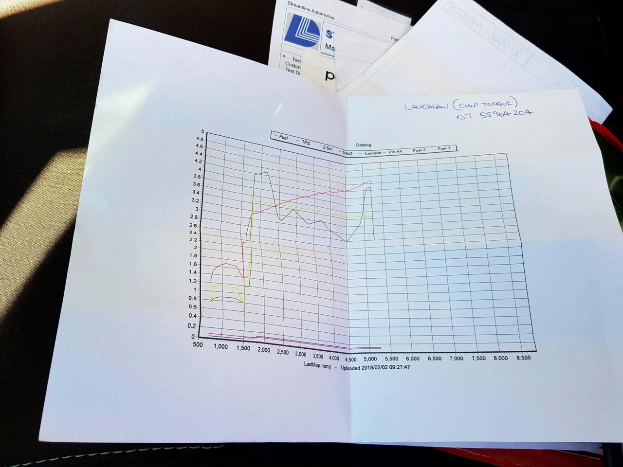

    I do have the orange virus software in the car and my tuner has been able to tune the car fine but it still isnt right. This is what the tuner has given me. The Green is the throttle position over the rev range. 20180908_071453.jpg

    And unfortunately in australia we cant just walk to toyota and they give us the software cause all those supercharger files arent available here. In australia we only have 1 supercharged hilux which is automatic and doesnt have vsv or tc.

    The calibration id in my car is 89663-0kt50 (30kt5000)
