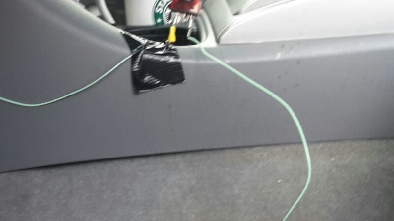

  5. Feb 10, 2015 at 7:53 AM
    tacomawhite
    tacomawhite [OP] Well-Known Member
    Jul 25, 2013
    #109029
    49
    07 PreRunner White
    Was able to get mine working by ghetto rigging a toggle this am before work. I'll be hooking up micro bypass when it arrives. If anyone fancies my elaborate setup below I can send you the kit with detailed install instructions for the low price of 29.95. Free shipping!
