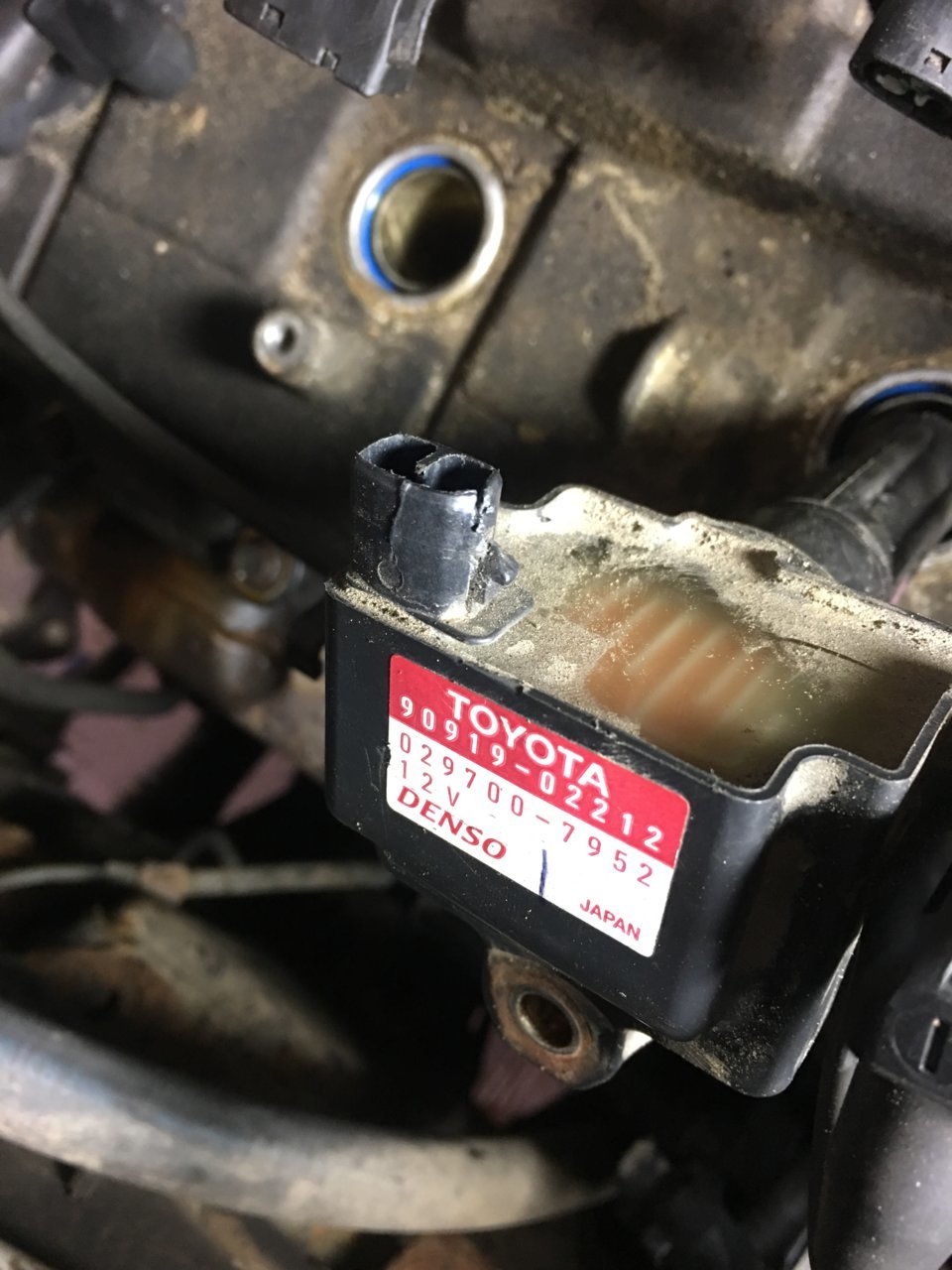

    So I decided to disconnect the battery for a bit and see what happens. Reconnected it and tried to start. All other codes are gone, now I have
    P0351 Ignition coil A primary/secondary circuit
    When I hooked the coil packs up I noticed that cyl 1 coil plug didn’t click in nice and fucked with a bit, but figured fuck it, it worked before. I looked at it closer and it’s cracked in 2 spots and one of the pins was bent down, tried bending it back up but still doesn’t seat nicely. New coil pack on order at Napa, be here tomorrow.
    Just want to say thanks a million for all the suggestions and help. I’ve been on many many forums and you guys definitely are some of the most helpful bunch I’ve encountered!!!
