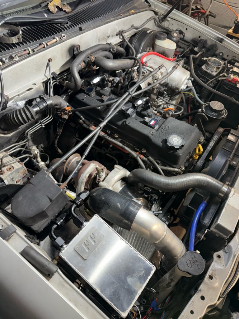

    I only have 7 pounds of boost, but I do have a blow off valve , external wastegate and front mounted intercooler with a 3” exhaust. Need to know what is the best and most likely the cheapest way to tune this motor.
    I was told the only way is with a Haltech standalone ECU , but I have seen people with these motors working fine without one, how are they doing this ?
