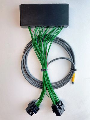

    I would give these guys a call and they'll set you straight. Its a lot of money but it also means no having to deal with wiring anything up. Plug and play then simply get it tuned. If you plan on having someone else tune it I would call around and see whos familiar with what ecu brands as that may effect how easily you can get it tuned.

    The stuff that company uses is all off-the-shelf anyway might as well buy it separate and save yourself a good chunk of money.

    The value is in the pnp harness or custom harness options. If you were gonna buy just an ecu sure go buy it somewhere else but not many places sell pnp harness for first gen tacomas.

    Boomslang does, It's where the ones that come in that kit come from. Might as well just support them directly, they're a nice group of folks and they've taken a few notes from me about their harnesses for these trucks specifically so they're wired ideally for a Haltech.

    I am familiar with boomslang. The only reason I mention them is when I was looking for my truck boomslang only offers there harnesses with a manual option. Versus snpspeed has auto options. Maybe it's just not listed on the boomslang website or are custom made by boomslang for snpspeed?

    If you ask Boomslang to make it they will make it, they're very responsive to their email and they have the designs for all these other options. I just setup trans control for someone else with an older Boomslang passthrough (piggyback) auto harness from SNP. They'll also do oddball configurations too for people with say, an auto to manual swap that was done previously. I agree that you could buy all this stuff through a middleman and it might be a little easier legwork wise but I don't think it makes up the dollar value at all.

    I sent boomslang 3 emails and have not tried calling them directly , but the 3RZFE w/ MANUAL TRANNY option is $600 and I am sure they make one for teh AUTOMATIC as well, just have not recieved any emails as of yet. The guy selling the Elite 1000 is asking for $800 without any harnesses at just the ECU and that yellow USB cable. I am also going to need a reputable shop to tune it. I am in New York, so finding reliable shops are almost non existing. When I emailed boonslang I asked them if I can use the Elite 1000 with their custom harness, I mean if this deals falls through , I will not have a choice but to pay the extra $$$ :(

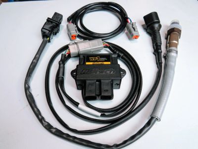

    I may be getting the WB1 for like $180
