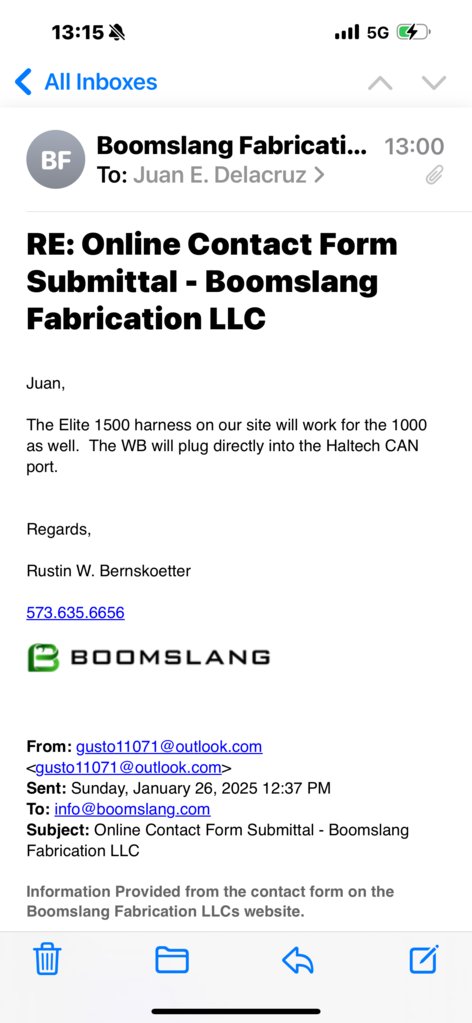

    So, the Elite 1000 and the 1500 are basically the same as far as wiring and I asked BOOMSLANG for a quote on the custom
    Harness for the Auto transmission and it’s a whooping $765 plus shipping ! Wow ! This is getting expensive.

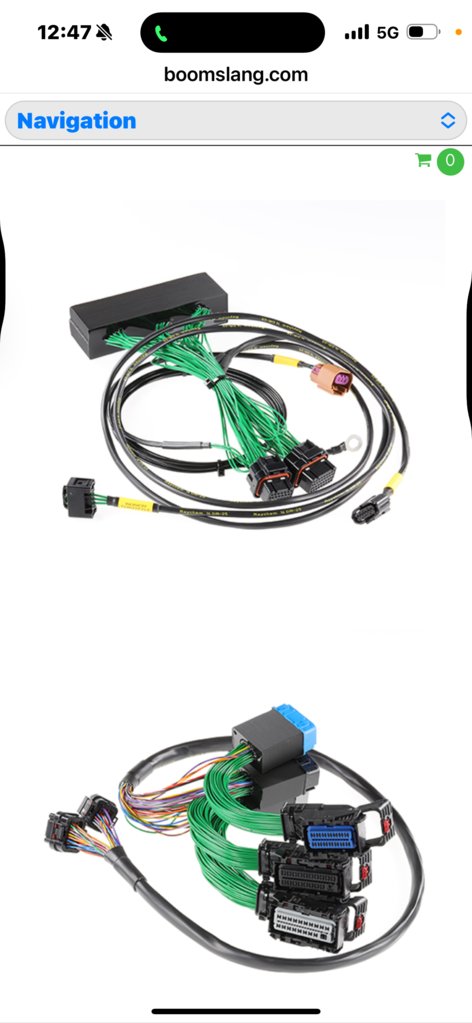

    Check out the PNP harnesses from URD if you want to wire it in yourself so save some money over Boomslang. Just need to figure out which Type you need. My 2000 Tacoma 3rz used a Type B IIRC
    https://urdusa.com/plug-n-play-harnesses/

    The hardest part is knowing what wires serve which functions and the correct pins on the Haltech, if you're new to it. Actual pinning is easy, so that's really what you're paying for with the Boomslang

    I am going to go with the BOOMSLANG plug & play harness for $765 + S/H I don’t want to mess anything up or end up frying my OEM ECU

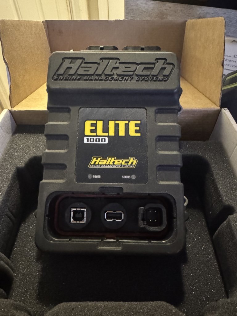

    Just got it ! I just have to wait for the BOOMSLANG harness now. Oh yeah !

    Huh. Weird that the 1000 came with 2 USB ports
  20. Feb 3, 2025 at 8:40 AM
    #60
    Speedytech7
    Feb 20, 2014
    #123587
    58,528
    FCQM+VG Cheney, Washington
    It's less Tacoma and more mod
    All dual connector ECUs did before 2022 and then they changed them as the USB A port was never implemented for any functions in software
