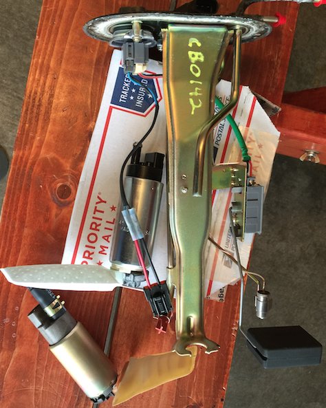

    So I dropped the tank and replace the sending unit. light still not on. please help.

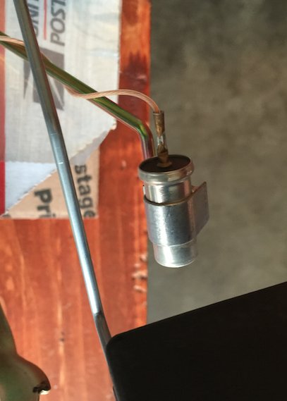

    Thanks anybody, it was fixed. the little thermistor under the float unit was gone bad. the warning light did come on then needle sits past last line.

    This thing, incase somebody need the pics.
    Screen Shot 2016-05-20 at 1.44.53 AM.jpgScreen Shot 2016-05-20 at 1.45.21 AM.jpg
