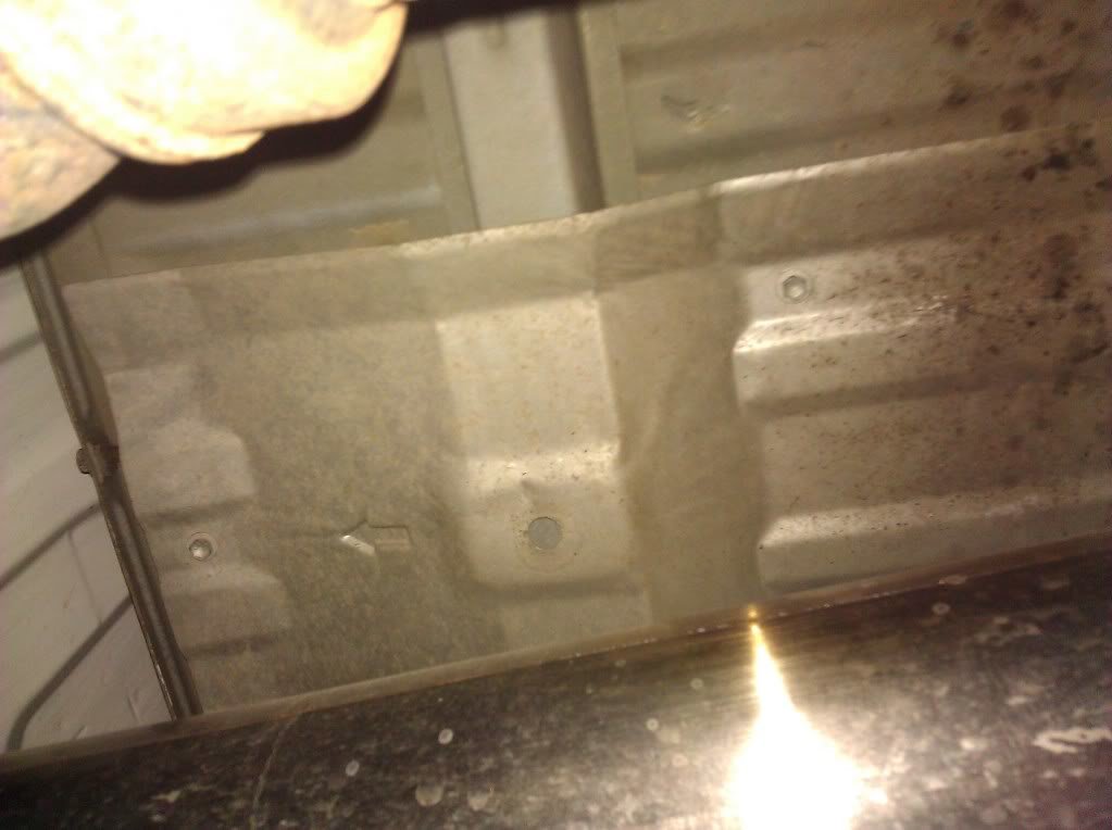

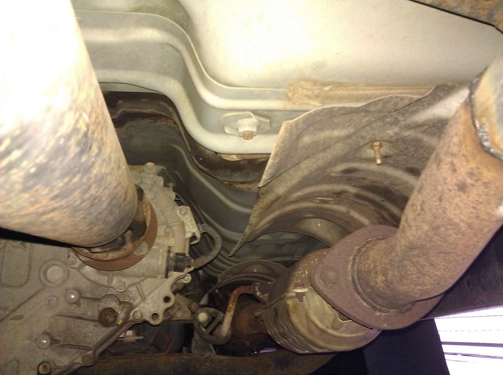

    okay so I found 3 heat shields. They all seemed to be on there very tight, but I got probably about a quarter of a turn on the bolts on the heat shield over the muffler... the two others were on there very well, but I still got the bolts to move a little when I went to tighten them...
    here is the one over the muffler:
    and the other two just before, and over the cat.

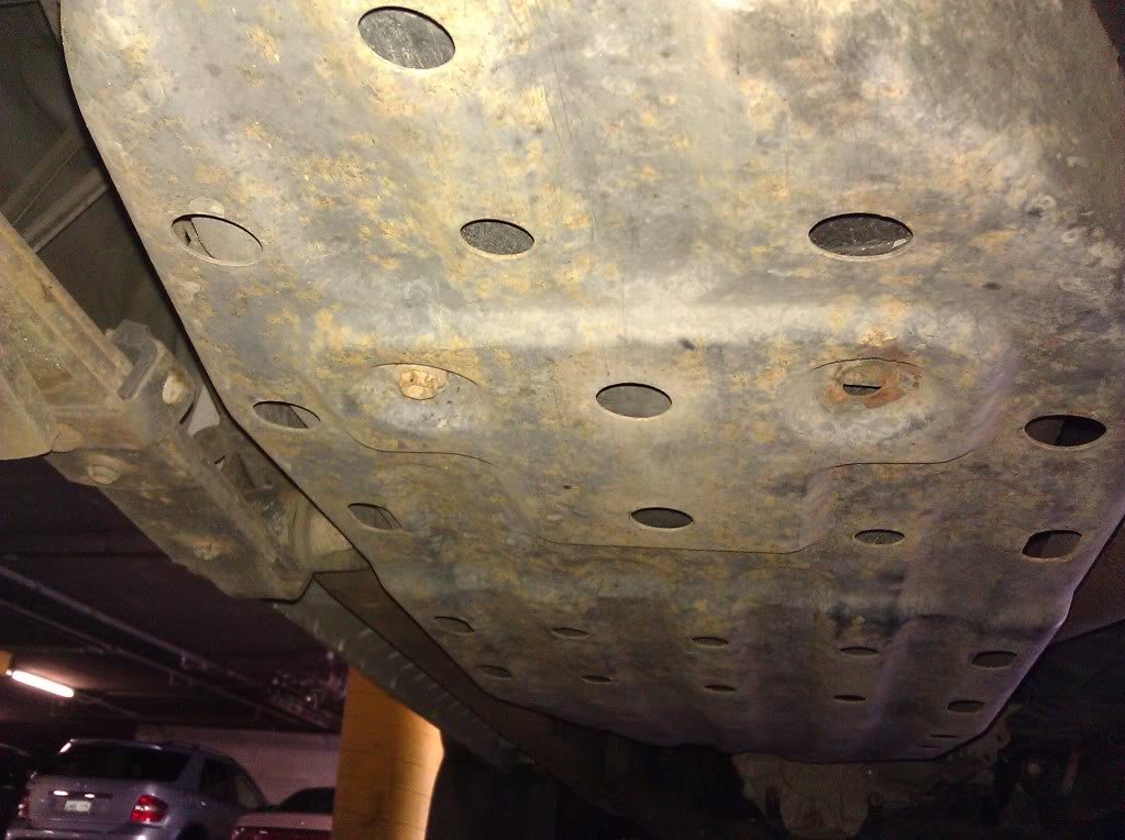

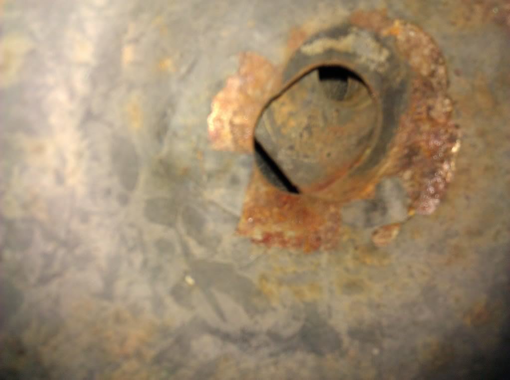

    then I started testing every bolt I could find and came across a missing bolt on the skid-plate under the gas tank... I hit the loose part and it sounded like more of a rattle... not the squealing like I heard before... could be unrelated... but I'll order the bolt anyway.
    the only thing is that the other 3 bolts are on the skid plate just fine... and the hole doesn't line up where the bolt is missing...
    I'll take the plate off and try to get it to line up but for now I'm not going to touch it until I get a chance to drive it to see if the heat shield fixes my problem! If it still persists the gas tank is next!
