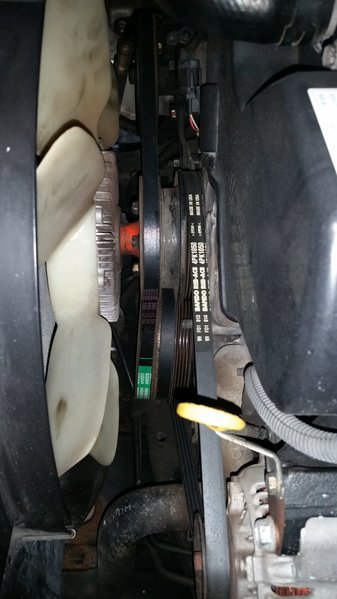

    Had my timing belt and all belts done about a month and a half ago. Everything seemed good...just drove hone from work and notice the battery light came on and hard to turn the steering wheel. Get home..pop the hood..and see this. Looks like the bottom pulley is not sitting at the right angle
    20170424_155836.jpggoing to call the mechanic asap..any ideas?

    Looks like the crank pulley is barely hanging on. Don't drive it or even start the engine til it's fixed

    I only drove about a mile like this. Does this seem like faulty mechanic work since I'm guessing this was part of the water pumping/timing belt install?

    Yes, looks like the crank pulley bolt wasn't torqued correctly or even at all. Take a closer look and see.

    Are the bolts on the harmonic balancer all seated flush?

    Shit...just reached my hand down there and I can move the bolt with my fingers...do you think this destroyed my motor?

    I think your motor should be fine. Things to look for is damage to the crank pulley and portion of the crank shaft that the pulley rides on. Also, the crank bolt.

    Your motor should be ok, I would imagine the bolts to the Harmonic Balancer are trash

    Hopefully they didnt overtorque it. Might have just over looked tightening the balancer bolts...

    Just got it back...they put a new crankshaft pulley on it and used locktite on the bolt this time. Luckily nothing else was hurt.
