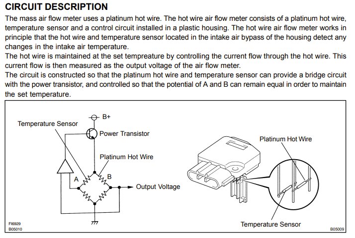

    The temp sensor is part of the MAF.

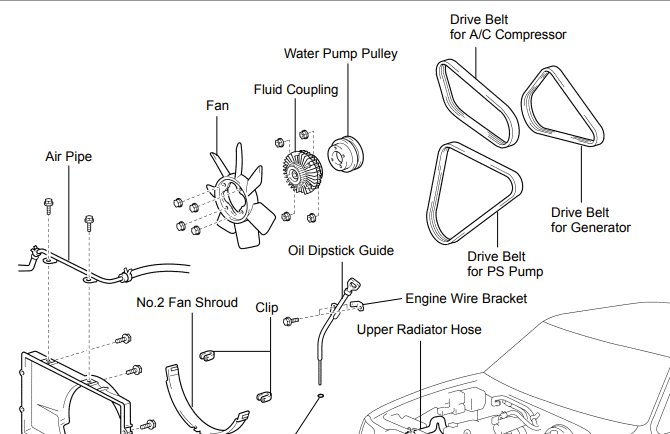

    Does this help with the belts?

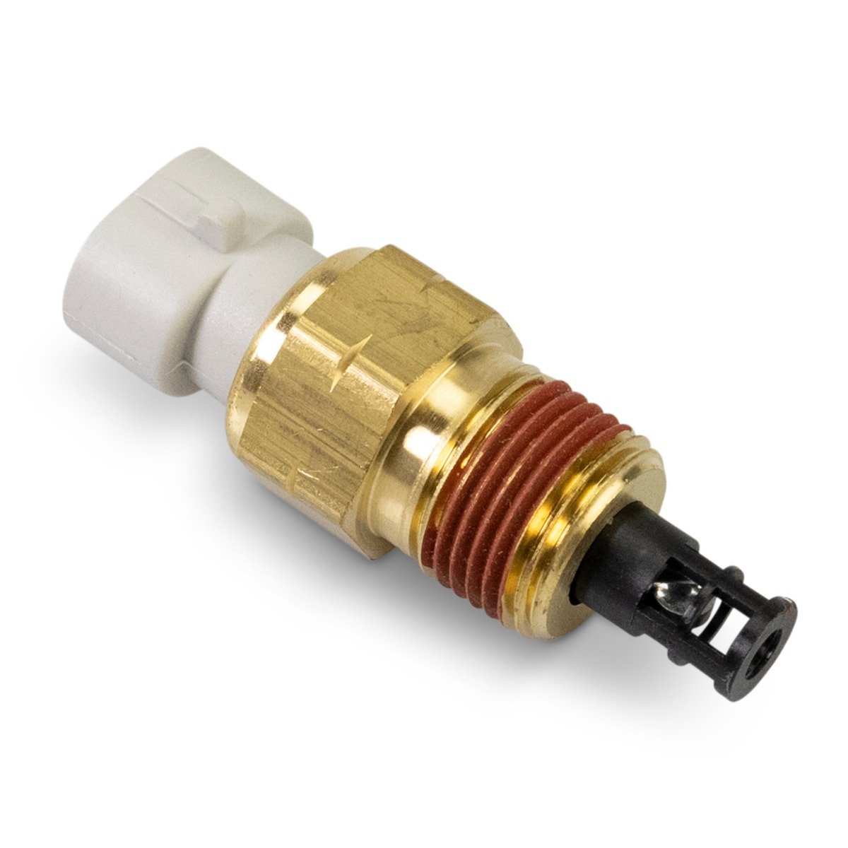

    Thank You so Much, I was confused since nothing in the engine resembled an air intake sensor. So I won’t be needing one of this then, since its upload_2024-4-7_19-39-27.jpg already built in the Mass Air flow meter.

    Especially since that's for a GM.
