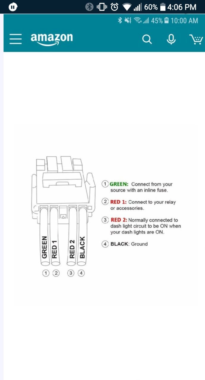

    So I’m thinking. I wired up the switch for my compressor like this:
    Green to an add-a-fuse on the dome light circuit.
    Red 2 to an add-a-fuse on the tail light circuit.
    At this point could I just run red 1 to the red from the lightbar harness, and black to the black on the lightbar harness?
    I’m not sure if I tried this combination today. At least I ran the harness through the firewall so that when the lightbar comes I don’t have to do that.

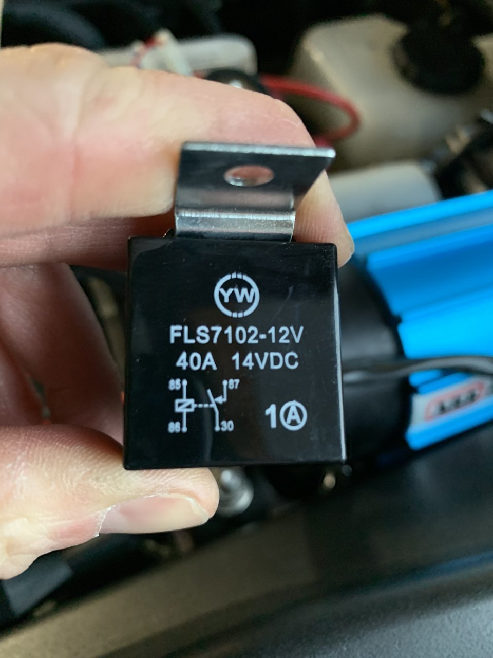

    Went out to the truck again today to test out another configuration. I think I figured it out, but can't know for sure until the lightbar comes in (I don't have it because it is coming with the SSO bumper that I ordered). With that being said, I think I have the switch wired correctly like this:
    • green on the switch to the red on the harness to the bar
    • red 1 on the switch I did not connect anything to
    • red 2 on the switch I used an add-a-fuse to connect to the taillight circuit (the words on the switch illuminate when the dash lights come on)
    • black on the switch to the black wire on the harness to the light bar
    When wired up like this the words light up with the headlights, and the top part lights up when I activate the switch. I tested voltage at the connector ends and never saw anything. However, I also tested voltage at the relay. Testing the pin labeled 87 (see picture below), I get roughly 9 volts when the switch is turned on, and nothing with it off. I'm no electrician but I think this is the desired result? Anyone who know about how to read the relay diagram see another explanation?

    With this setup, does the top part illuminate when the light bar is on? That was the only thing I couldn’t get to function. The bottom part lights up with the dash, but when I turn the bar on the whole switch goes dark.

    Yes, the bottom lights up with the dash lights and the top lights up when the switch is activated

    Ok good to know. I feel like I tried all possible combinations, especially since red 2 and the black from the switch aren’t variables. I made a few posts and called companies and still got no luck beyond what I posted above. I’m going to be tearing my dash apart in a few weeks as part of a wiring overhaul, so I’ll try your setup again. It really bugs me how the switch shuts off when the lightbar is on.
