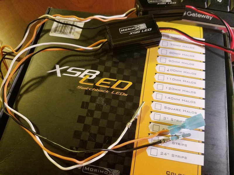

    2015 White DCSB SR5
    OK. XSB Switchback LED by Morimoto

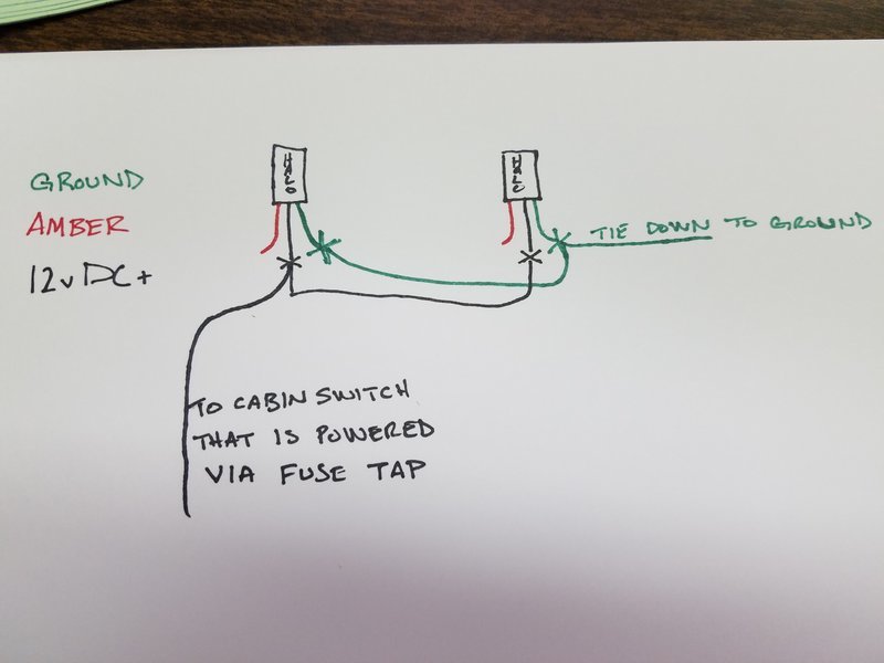

    2015 White DCSB SR5
    Guys, thanks a ton for helping with what are clearly amateur questions. Could u look at my sketch and tell me if I am setting it up correct?
    The "X's" indicate where I plan to solder/splice wire to.
    I am not sure how/where I will tap Amber yet. I know @gym_jamz ran individual wire from rear tails, but I'm not sure how to go about all that and what it would take.
    The end result I am striving for is:
    -Ability to manually turn halos on/off so I can prolong their life by not running them 24/7 and while low beamspeed are on.
    -Amber switchback function always working
    How far off am I from this goal in my sketch?
