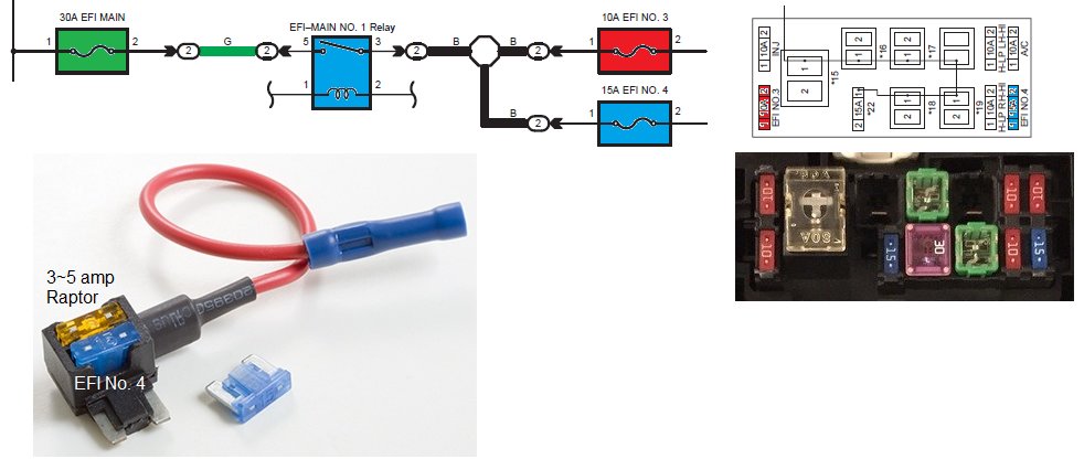

    I know this topic has been covered extensively and I've read through some of the threads trying to find the exact info I need but I thought it would be most efficient to ask directly in my own post. I'm trying smtp tap a fuse (low beams) to power 3 led raptor lights (runnin4taco style lights) but I'm a little unclear as to exactly how to do it. I know which fuse to tap, and I know the add a fuse takes 2 fuses, but the 10 pack of add a fuses I bought only comes with the additional 15 amp fuses so what I'm confused about is an I supposed to use the original 10 amp fuse and one of the new 15 amp fuses? Can anyone with this set up clear this up for me or show me some photos? Thanks very much.

    Yes. You use the existing fuse and an additional one. I believe the existing fuse goes in the bottom slot.

    Why not just tap the parking light on the drivers side headlight being led they don’t draw shit and the existing fuse that those wires are attached to is more than enough...purple wire positive white wire is ground.

    Forgive me if I'm mistaken but then won't the grill lights only come on under certain headlight settings? I want the lights on all the time. Also, I would prefer not to tap into factory wiring if I don't have to, I like that I could put everything back to stock if I want to with the add a fuse solution.

    because if you use the add a fuse, you don't need to tap into factory wiring.

    This would work also...
