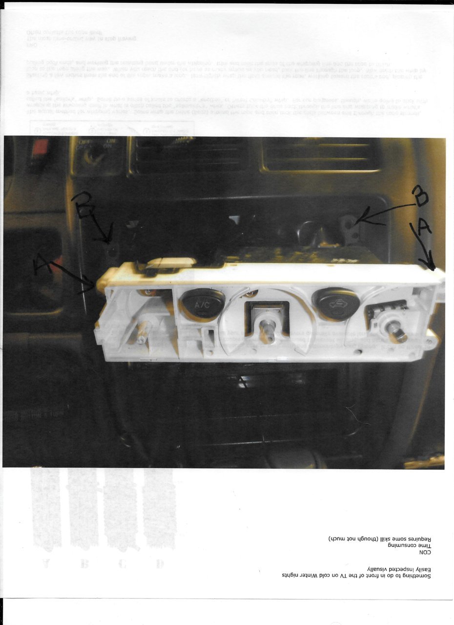

    Ok guys n gals. I had to replace the light bulb behind my air control knob. I successfully got the box out,replaced the bulb and now I'm really having a hard time getting the box back behind the brackets that hold it in! Any hints on how to get screw bracket "A" behind screw bracket "B"? I did get it in the past, but I think it was sheer luck that i didn't break it...Tacoma.jpg

    you're supposed to take that whole vent/radio cover (bezel) off, it's held on by three(3) screws on the bottom and two on top of the A/C/vent controls, then just pops off.
    https://youtu.be/KO_jhfGIVVI
