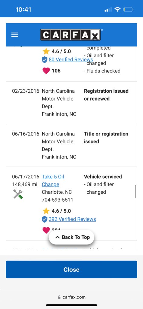

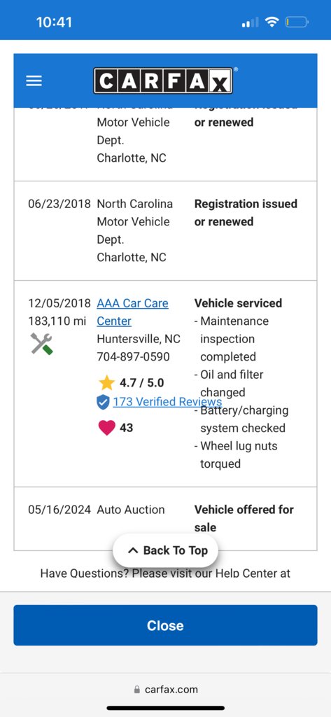

    Found a first gen that meets all the criteria I want…but it leaves me with questions. Past 2018 there is 0 zilch nothing on carfax, not even registration. Milage in 2018 was only 100 miles off what it currently is. Has standard 20yo truck issues. Has cobwebs under the dash and what looks like where mice had stuffed grass in various places and mud daubers nests on the engine.
    has three pending evap codes and not enough miles to set off the cel yet so the dealer is letting me add some road time to it tomorrow
    but it leaves me pondering…why did it just sit for 6 years?? Any insight? Vin is

    I don't think anyone on here is going to be able to read the owner's mind and tell you what went on with the truck since 2018. The 35k mile gap between oil changes jumps out to me (but maybe he had them done at a shop that doesn't bother with Carfax or DIY'ed them in between).
    It clearly sat for years based on all the info you have shared. Now you're just gonna have to thoroughly inspect, road test, question the owner and then weigh out if you think it's worth the risk.

    Before that jump it was about every 6k miles, and that jump coincided with him moving to a new area.

    It only has 100 miles put on it since 2018 was the red flag

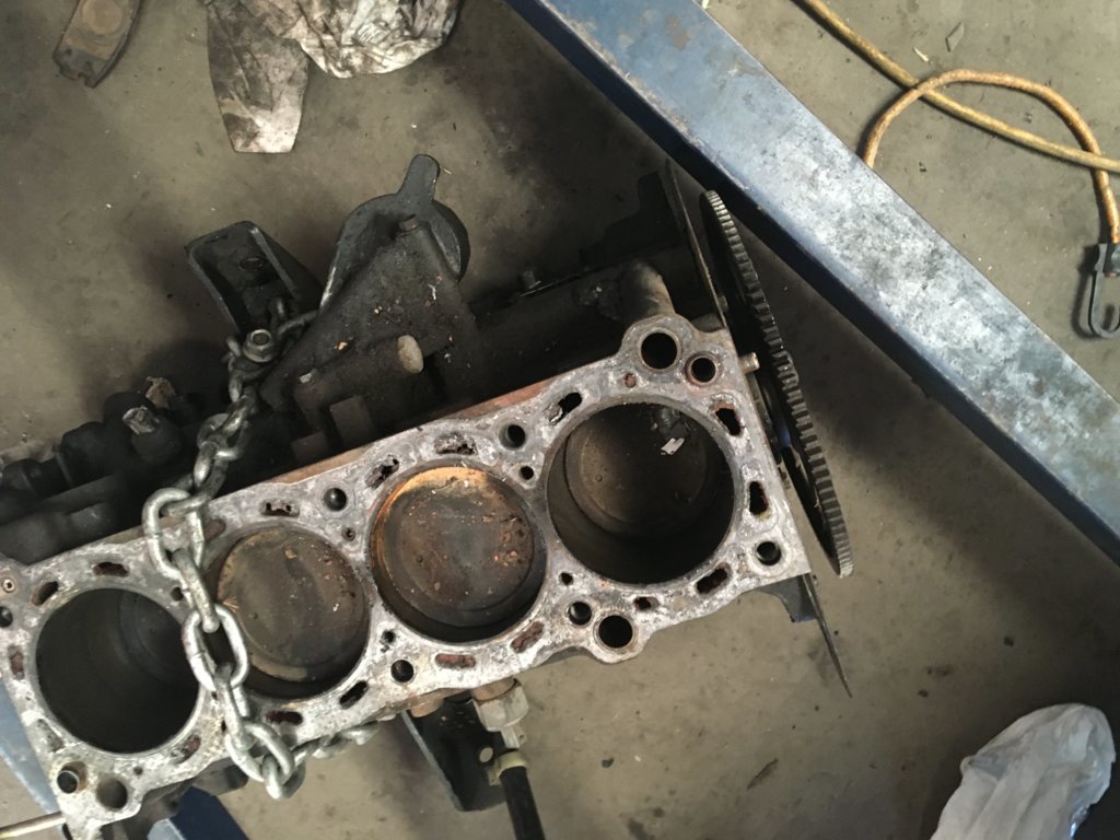

    So I bought the truck and think I found why it may have been parked for so long. No records past 2018, at auction the truck sounded like it ran like crap. Tore into the timing belt and found it’s been changed in 2020. So I suspect the motor may have been replaced by the dealer I bought it from. Is there any way to cross reference engine serial number with a vin to see how many miles the engine has to it?

    I would do compression test.....leak down test
    and maybe even test the coolant with a combustion tester
    that way you'd get a round robin of the most important life indicators
    valves/rings/head gasket
    probably no.1 reason these sit for months/years is failing head gasket.
    When they price that job they put it off...
    If they continue to drive it....it scores that cylinder....
    IF they park it for too long like that.....it rusts the block and metal gaskets
