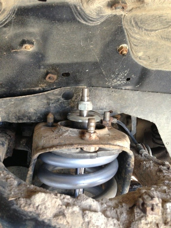

    F8EBDED1-ECFB-4917-9EFC-E4E9DF436AA9-918_6ea7528ca161a5e0e97694f8dc12eb556d12d2a4.jpg
    That.. sorry i thought i put the picture in the first post. Yes i know its missing a bolt I was putting a new bolt on

    Wtf? Man that does not look right or safe. Who assembled them?

    They forgot to put the washers and bushing on the strut below the top plate, i got a spring compressor and fixed it, glad i figured it out finally!

    That's great man, something wasn't right glad you found it. Now go get your money back from whoever assembled them lol
