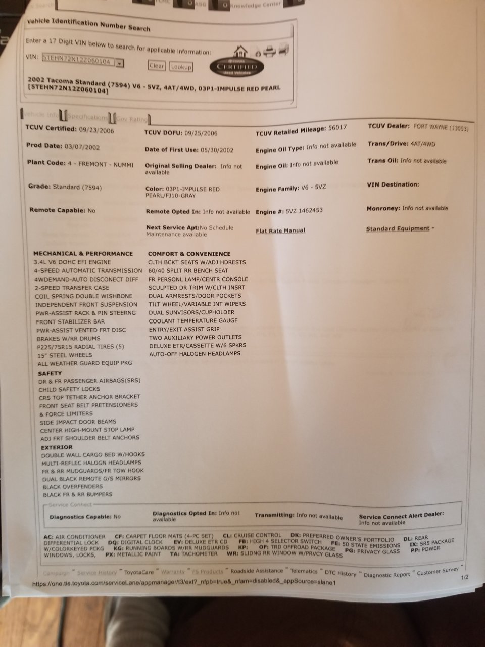

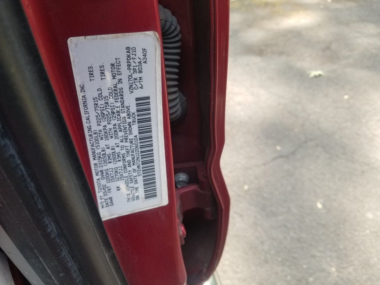

    Hello TW,
    I hope you're all doing well.
    I recently got into an driver front end accident and after repairs by a dealer the vehicle now grind when turning on the drivers side. The dealer says that its due to the truck using an oversized tire versus what the door sticker states. The door sticker and vin decoder state that the correct size is P225/75R15 but I'm running the oem P265/70R16. Its a 02 doublecab with offroad package although the decoder doesn't state this information and the dealer states I just have the standard. Toyota stated that the previous owner may have changed the tires, added lockers, changed door stickers and in order to prove them wrong I need a dealer to confirm that the sticker is mislabeled as P225/75R15. Is there anyone out there that can help me with this or know a dealer in the north eastern side of PA that can help?

    You need to do a second vin lookup (from another dealer) to see what options your truck left the factory with.
    Are you the original owner? If not, then you can't be certain that a previous owner didn't do exactly that- swap the rear axle and slap some stickers on.

    Did it grind before the accident? If no, then might want to take it to another mechanic/svc department. If the work was covered by your vehicle insurance, I imagine they want it done correctly. Sounds to me like the repair and or alignment wasn't done correctly or perhaps there is more damage than what they fixed (frame?).

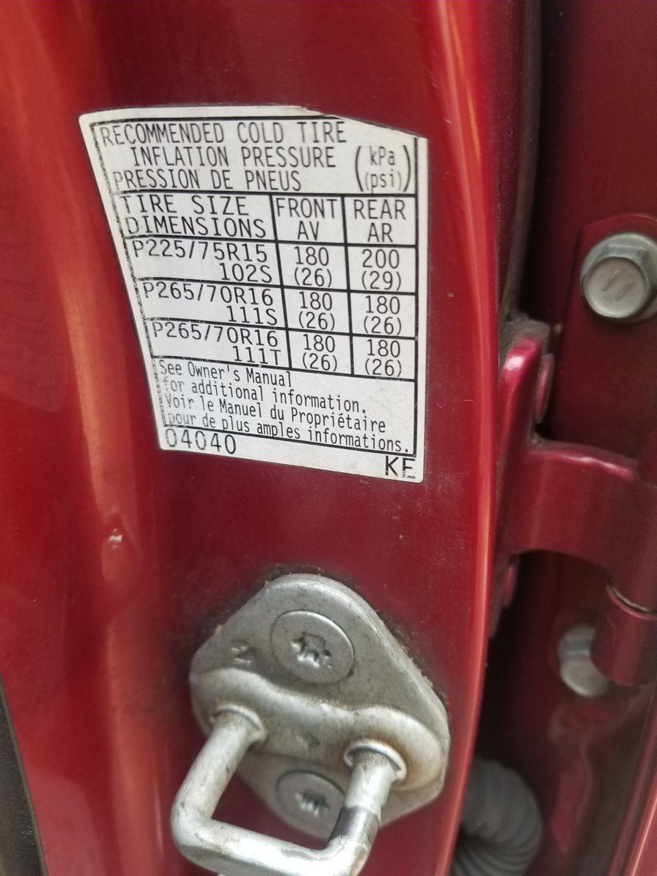

    The door sticker shows 3 tire sizes. The two spec sheets you attached do not mention the TRD OffRoad option. If it had the TRD package from the factory, it came with 265/70/16.
    This is what my VIN returns --

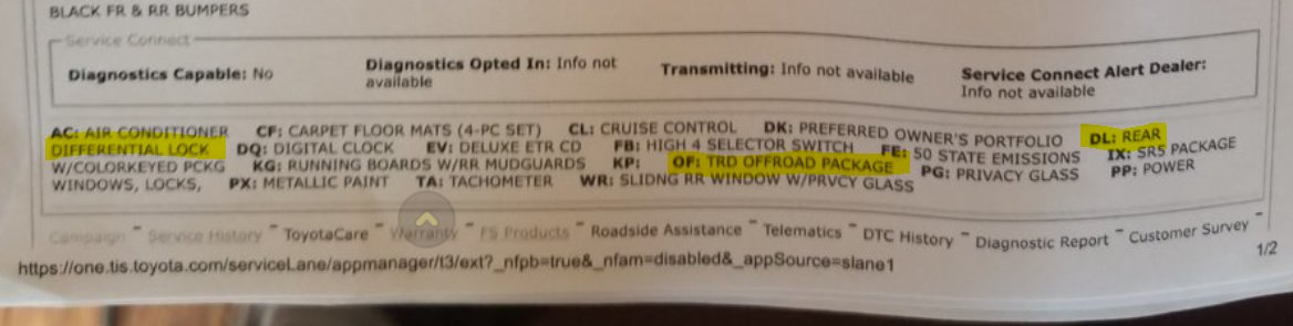

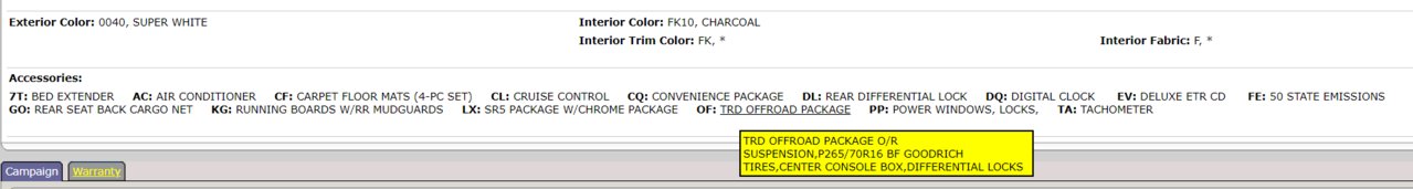

    Hi all,
    Thanks again for the help, here is more info I found about the truck. I'm thinking of having inspected else where and just forking out the money to repair it as its becoming frustrating. 20220826_151424[1].jpg 20220826_151327[1].jpg

    Right and because your VIN shows it has the TRD Package (from the factory), it came with 16" wheels and 265/70/16 BFG tires. Tell that dealer/svc person to look it up and it will clearly show it in their own sys.

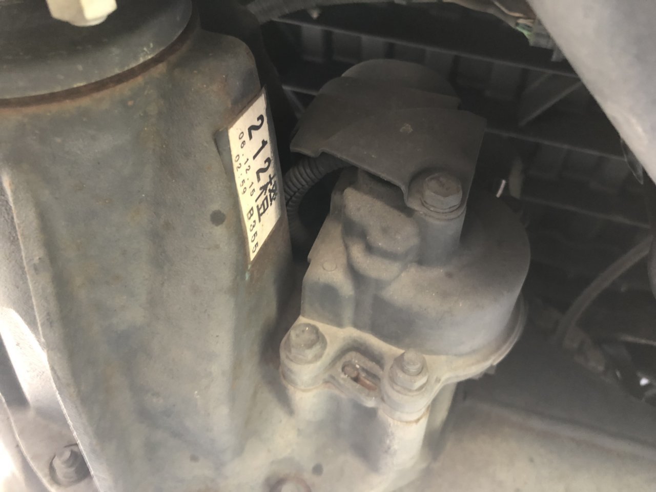

    This is easy. Crawl under the truck and see if you have this bolted to the rear differential.

    He has the factory rear locker.

    Nope, that is what is on his truck. Confirmed it via VIN and TIS.

    If that locker sticker is there (not in the stock location) then that's probably why they thought someone swapped an axle in. What's on the flip side of your visor?
