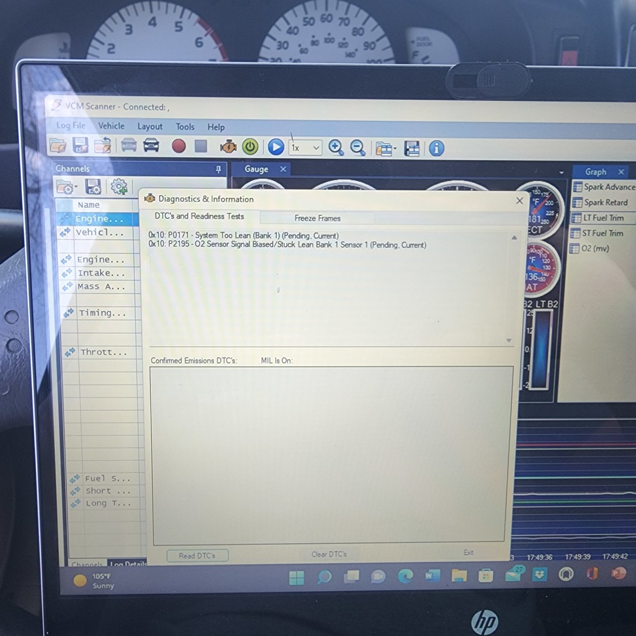

    2004 tacoma 3.4 prerunner
    16574934138243388320992763465821.jpg 16574934440161726357563048578813.jpg 16574934138243388320992763465821.jpg 16574934440161726357563048578813.jpg 2004 tacoma 3.4 l v6 changed the cats and both o2 sensor (denso) getting 4 codes still p2195 p2238 p0171 and p0030 I'm at a loss. I'm thinking injecotrs now .runs fine has plenty of power still when I scanned it with the hp tuner short term and long term fuel where pretty high like double digits and then one it reached 29% it got stuck on lean . I'm very much confused and this is a well Maintained truck

    Check for vacuum leaks

    The test ima try is the dangerous method. Carburetor cleaner I'm saving up for some machine . Unless there is another method you guys recommend

    All the hoses look good I've replaced some and no rpm changes ,went through 2 cans of carb cleaner and nothing changed so I assume no major leaks or vacuum. Still scratching my head .
