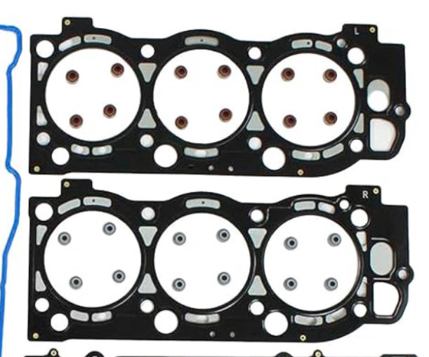

    I dont know about toyota but on fords most of the time the head gaskets are labeled / stamped one way or another for correct orientation on the engine.
    something like right / up & left / up....
    then theres a stamp showing front...
    Just cuz you put them on & they fit doesnt mean its right...
    This part is very important as theres small passages that can be blocked off & shouldn't be if not installed correctly, like coolant passages.
    Not sure if youre aware of this...
    If you weren't, call the gasket maker & have a conversation with them.
    When working on cars right & left is always as if youre sitting in the car....
    Even if youre working on it,
    right side is always passenger side, & so on...

    The head gaskets are 100% on the right side. I spend a good amount of time making sure gaskets were labeled correctly to the oriented heads and the holes correctly matched up. I followed Timmy the tool and video to a T on the head gasket change. With that being said I did notice that on the new MLS head gaskets I installed some of the passages were purposely blocked off. Timmy also makes a note of the same thing with his head gaskets in his video so I didn’t much of it.

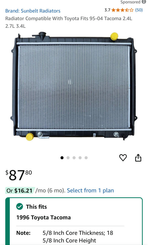

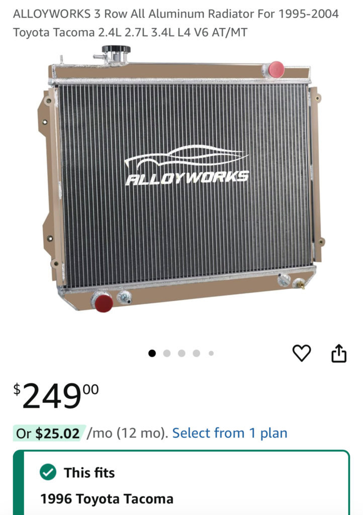

    So I’m taking your guys advice and going with a new radiator. I’m seeing quite the difference in price from eBay/Amazon around $70-110 up to $250.
    Is there really that big of a difference going cheap vs expensive ? I really don’t want to slap a bandaid and deal with another radiator issue in a year or two. After getting burned with going with the cheapest engine I’m willing to spend a little extra on parts.

    Inregards to radiator brands im sure theres many on here that know way more than me...
    Did you check the brands available on rockauto.com?
    Dont think you really need to go crazy & get an all aluminum radiator....
