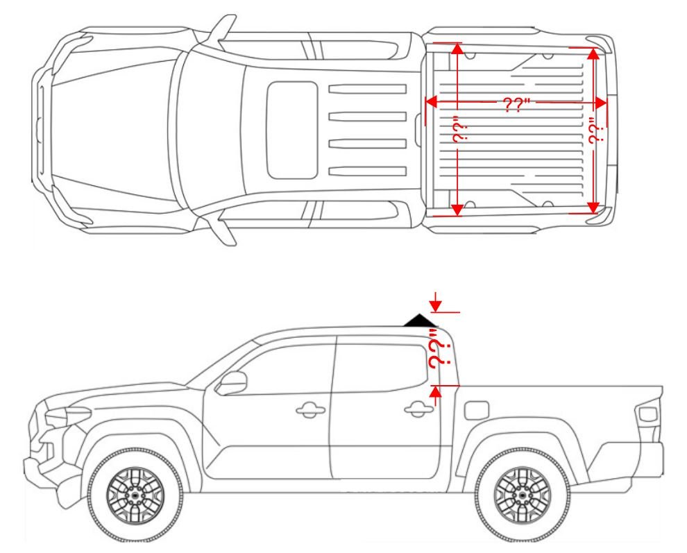

    I'm purchasing a camper tent and I need the exterior "outside" measurements for a 2016 long bed.
    I have a camper shell on and I cannot get an accurate measurement. Any help with this would be appreciated.
    Thank you!

    Thanks @TA2016, but these are interior measurements. I need measurements that relate to basically adding a camper shell.

    These measurements won't be 100% correct, but pretty sure within 1/4-1/2"
    Height: 21-22" (guestimating where top of shark fin is from ground level)
    bed length: 79 5/8"
    front bed width: 64 1/4"
    rear bed width: 62 1/4"
    I have a Pace Edwards canister tonneau cover on, so the numbers aren't perfect
    Hope these help.....

    I'm getting similar to Pops, give or take.
    Height: 22" (eyeball 'level')
    bed length: didn't measure (factory tri-fold tonneau)
    front bed width: 64"
    over the axle: 63-1/2"
    rear bed width: 62"
    Measured to the outside edge of the plastic cap. Looks like the width tapers down the most in the last foot near the tailgate.

    Thanks @CB350G & @PacoDevo. These are the closest measurements that I've received so far, to my measurements (with my campers shell on guess-timating).
